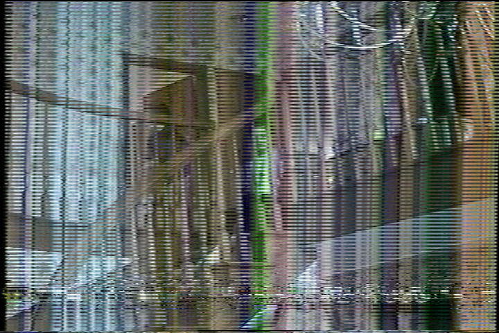

  1. I attempted to clean the video heads of my Hi8 camcorder with isopropyl alcohol and a Q-tip, and now it appears to have ruined it. I heard Q-tip are not that good for cleaning, but they should still work. I even let it sit a few hours before using it. I am not sure what I am doing wrong.

    Normal Isopropyl has more impurities than the kind of head cleaning fluid you SHOULD be using (denatured alcohol, freon tf, etc), so you could have added residue to the heads. In effect, UN-cleaning them. Plus, the percentage of water in the solution may be enough to promote corrosion (unlikely).
    Also, Q-tips are a NO-NO, as the lint/fibers can get caught in the head gap and abrade the head and gap.
    Whoever told you to do this did NOT know what they were talking about. And, unfortunately, it seems you don't either.
    Before doing any more possible damage, either learn to do it the right way (proper solution, proper materials - such as lint-free sponge (foam) swabs, and proper technique), or take it to a professional, and get it RE-CLEANED. Then pray that you haven't already done too much unrepairable damage. Sometimes after such a cleaning (and ONLY after), you can "buff" the head with repeated recording/playback/trickplay of a pristine recorded tape, but since you are early in your learning curve in this, I don't recommend you try it yourself.

    The picture in post #1 suggests one of the two heads is still working, it looks like one interlaced field is OK and the other is missing. There are two heads, mounted on opposite sides of the drum so there is always one in contact with the tape as it partially wraps around it. The bottom few lines look to be normal for VHS interlacing which suggests the head switching signal is still OK. There is a chance you can still recover it.
    Try hitting 'pause' a few times while playing back your tape. If one head is still OK, there is a good chance you will randomly stop on a good picture.
