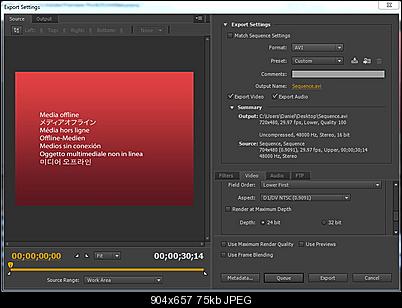

  6. What is the difference between converting from YUV -> RGB32 -> YUV and just keeping it YUV? Since it uses 32-bit floating point numbers, and the rounding errors are tiny, the color loss is insignificant. Right?
    Also, would there be any difference between 24 bit and 32 bit? What about Render at Maximum Depth?
    At the bottom there is a setting called Use Maximum Render Quality, which I have heard it has been tested, and it results in no improvement in quailty while significantly increasing render times?
  7. Originally Posted by Hypersonic1 View Post
    The difference is colorspace conversion. They are non overlapping color models (There isn't a solvable 1:1 representation of all values), so there is always some loss , also from rounding which is minimized if you use higher bit depths. Eitherway there is measureable, observable loss. Whether or not you can "see" the difference with your own eyes on your type of project or footage is a different matter. For some people the loss is negligible, others feel they have to use best practices. Only you can answer what workflow is suitable for your goals
    Those selections in your screenshot mean 24bit total (ie 8bit per channel or 8bit ie. 8 red, 8 green, 8 blue if working in RGB. 8 Y, 8U, 8V if working in YUV). 32bit isn't 32bit per channel, it's an added alpha channel if you have a valid one , otherwise a dummy channel is added .
    Yes, MRQ is much slower but it enable certain operations like better resizing algorithms (modified bicubic instead of bilinear), 32bit processing on the CPU instead of 8bit - It might or might not be worth it depending on your situation and project specifics. Certain effects , situations definitely benefit like effects on gradients
