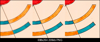

    Huh?
    The first image is 412×288 you resize that to 384×288
    The third image is 412×309
    We were talking about 720x480 right?
    (really 864x648 to keep it to scale with the original):
    You lost me completely here.
    720x540 goes straight to 1440x1080 by scaling exactly 2x
    640x480 to 1440x1080 is messy!
    So seriously if you would have to go from 720x480 to 1080 you prefer to decimate the horizontal resolution first to 640 and then do a messy upscale to 1440x1080 over a straight forward resize of 2x horizontal and 2.25 vertical?
    Stunning!
    Needless to say that edge "enhancement" (a darling some engineers even in the HD era can't still not get enough of) with standard bicubic upsampling gets increasingly worse as well:

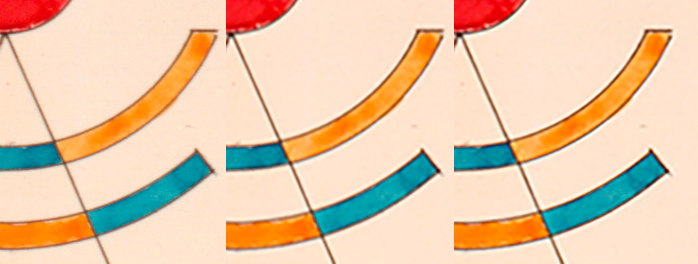

    Original - From 720 - From 640:

  3. Originally Posted by newpball View Post
    FFS!
    720x480 is 1.5:1.
    Pic #1 is 412x288 which is 1.43:1. Not quite 1.5: 1 but close enough for the point I was making. I just used it because it was there.
    Pic #2 is 384×288. That's 4:3 by reducing the width. Just like resizing the 720x480 DVD to 640x480.
    Pic #3 is 412x309, once again just like resizing a 4:3 DVD but this time by increasing the height instead of reducing the width.
    We then discussed resizing the 4:3 DVD to 1080p. ie 640x480 to 1440x1080 or 720x540 to 1440x1080.
    I resized pics 2 and 3 by a similar percentage but they're not 640x480 or 720x540, so the closest aspect ratio while maintaining the same relative upscaling to 1080p would be around 864x648.
    It's not a perfect example because pic #1 isn't exactly 1.5:1 so maybe I should have resized to a slightly narrower aspect ratio than 4:3 to compensate, but can you see any difference in the upscaled images?
    Stunning!
    I don't know what you're on about.
    (640x480) x 2.25 = (1440x1080)
    (720x540) x 2 = (1440x1080)
    The only thing that seems messier to me is stretching the height first and then upscaling it just because you like the look of the numbers better.
    The only "straight forward resize of 2x horizontal and 2.25 vertical" taking place is in your head, as stunning as it may seem to you in there. Either way, the video is being resized twice. Once when it's encoded, and again when it's upscaled. Anamorphic encoding is not an option. The player ignores the aspect ratio.
    Once again, show me an example of a real world DVD where it makes a visible difference or once again you're ignoring the examples that have been offered because they don't suit you. Debating a subject with an ostrich is fairly pointless. I've done you the courtesy of looking at what you've posted and commenting, how about for once you do the same?
    I'll leave you to argue about that one with yourself given it's not really anything to do with the discussion.

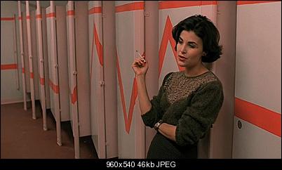

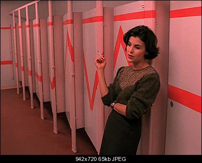

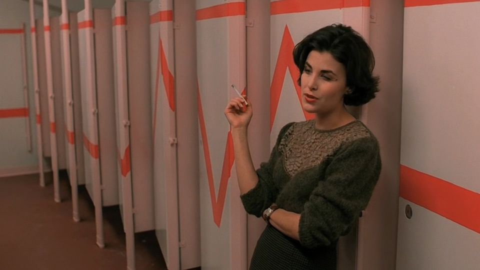

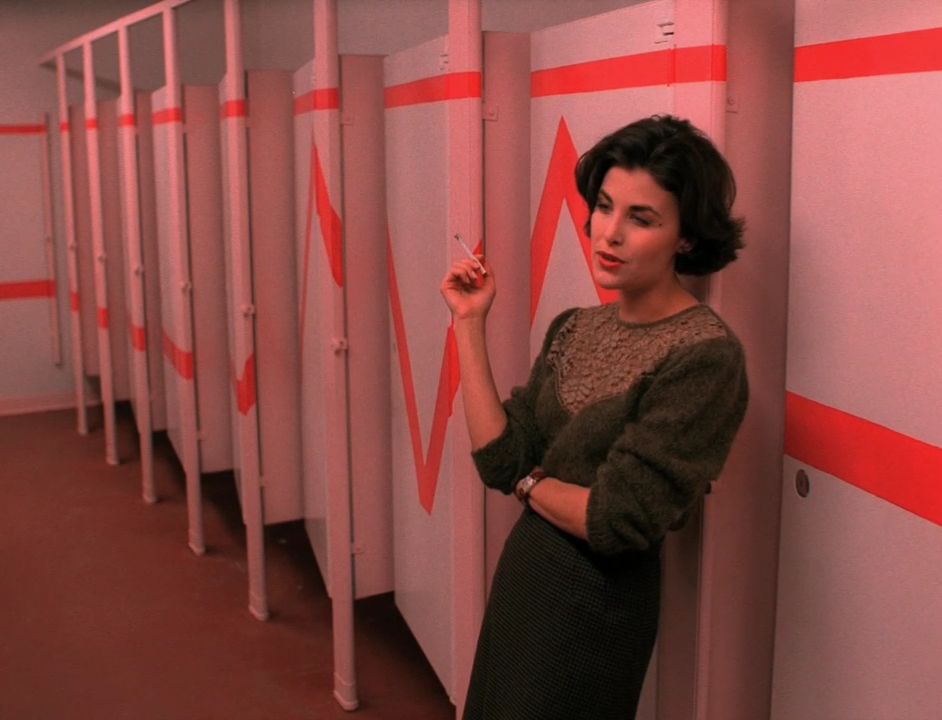

    I've been working on re-encoding Twin Peaks recently. It's HD which makes it easier to get away with cropping a lot of picture, but I started re-encoding because the over-saturated red look really annoys me (artistic or not, I don't like it) and while I was playing with that I started to crop a bit and got carried away. So I started out with the top pic and my encoded version is the bottom one.
    Some episodes were nice and easy. I set the cropping and it barely changed, while for a few I was moving the cropping up and down quite a bit (effectively panning and scanning) and that can take a bit of time when you're doing it with a text editor and Avisynth.
    Normally I'd use MPC-HC to zoom in the same way on playback and just encode at 4:3, but as I said, I got carried away.....
