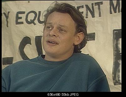

  5. Originally Posted by manofsteel31 View Post
    However the fact that we are taking the extra steps to resize the video to 640x480 which is 1.33, should be still be aiming to comply with the 1.367377 AR?
    Academy ratio is roughly 1.37:1. If that's what you have, is there anything wrong with 656x480? Is there something magical about 640x480 or 1.33:1?

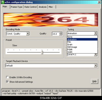

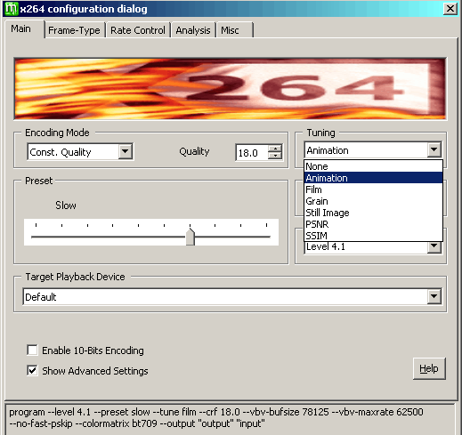

    ...but I just feel like mentioning that I encode using the "Constant Quality" Encoding Mode and adjust the "crf" value until I get a specific video bitrate of 2,200-2,399Kbps which I find to be Ideal picture quality
    You do know that makes no sense at all, don't you? You're contradicting yourself. Adjusting the CRF values varies the picture quality. If you want to encode to a specific quality pick a CRF and make all your encodes for that and don't worry about the final size. Almost by definition encoding to bitrates of 2200-2399 might give you wildly varying qualities. But, if you want specific bitrates then run two passes for your 2300 to begin with.

    When I first started encoding I spent months trying every encoding option in Handbrake and later MeGUI trying to find a picture quality I was consistantly happy with and was still small enough to be a reasonable size. Some of the encoding methods claimed that when they encoded a video that might use a different bitrate on different frames of the movie depending on if it needed more or less than others. I did not like that idea, and was led to believe that the "Constant Quality" would (as the name implied) Consistantly use the same bitrate on all frames throughout the movie so that every frame was encoding using the same bitrate as the last. That idea sounded ideal to me. While trying out every crf value between 15-27 on several small videos, I found that I was consistantly finding that my favorite encodes all had a video bitrate between 2,200-2,399Kbps. I have gotten much better at guessing the correct values now for that bitrate range. 1080p Blu-rays are typically between 23-26 and 480p DVD's are often 16-19.
    I continue to use that method because there are so many 2pass, 3pass, ABR, quantizer, automated, etc options and I did not feel like they encoded my videos the way I wanted them to. Again, just people one frame on the movie is a night scene and full of deep black color, I dont want it to receive less of a bitrate then another. I want the quality to be constant throughout the entire video. I know I waste a LOT of time re-encoding the same videos until I am happy with the final result, but I dont know of another way that gives me the constant quality I am looking for.

    ...and was led to believe that the "Constant Quality" would (as the name implied) Consistantly use the same bitrate on all frames throughout the movie so that every frame was encoding using the same bitrate as the last.
    I doubt you were led to believe that, and probably misunderstood what you were told.
    Most of what you think you know is just plain wrong. Not a little bit wrong, not difference-of-opinion wrong, but laughably wrong.
    ...but I dont know of another way that gives me the constant quality I am looking for.
    CRF 18. Don't overthink this.

    LOL .... using CFR 18 for every encode is crazy.
    Not if, as you claim, your interest is in having all your videos at the same quality. You sure as heck won't get that quality by doing it your way. However, many do suggest using a higher CRF for hi-def sources. I see 20 or 21 mentioned a lot. There are a lot of factors that go into how much a video will compress from its Blu-Ray or DVD source when doing them for the same CRF. If they're noisy or have a lot of film grain then they may not compress worth a damn. And if so, better than using a higher CRF to get the file size down and degrading the video quality more than you might like might be to make it more compressible by using a good denoiser.
    Since my focus is on small sizes as well as good quality, you need to treat each video as an individual as apposed to picking the same CFR value for every video.
    Okay, but don't delude yourself into thinking that your convoluted method produces anything even remotely resembling even quality among the different DVDs and Blu-Rays with which you work. Of course, you can do it however you like and if the results please you that's all that matters. Often times a lot of grain and noise can hide the imperfections in the results and some say you can get away with a lower quality when that's the case.

    First, which "2 pass" option should I be using? There are several Encoding modes listed in MeGUI. I am going to assume I should pick "Automated 2 Pass" and then just enter a value within the range I normally aim for (2,200-2,399Kbps) so lets just say "2,300Kbps" since its close to the middle. There are other options that say "2 Pass - 1st Pass" and "2 Pass - 2nd Pass" and a few others. So which should i be using?
    Secondly, I guess the idea is if I were to encode a video with Constant Quality and a crf value of 18, and it resulted in an encoded with with 2,314Kbps video bitrate, then encoding that the same video using 2-Pass and specifying the same 2,314Kbps would result in the EXACT SAME result. Is that really true? I understand that the end results might both display the same exact video bitrate, but how do I know that the bitrate was distributed throughout the videos frames in the same way as it would have been using Constant Quality? There is not really any real way to be sure. I mean, with the single pass Constant Quality encode, the encoder is not worried about being restrained by a pre-determined amount of pixels and gives each frame as many as it thinks it needs. Perhaps during 2-pass encoding, it is so focused about on staying within the pre-determined bitrate limit that is distributes the bitrate differently. You can only assume that the video is being analyzed the same way by the same software and is "probably" distributing them the same way. Maybe this is an OCD way of thinking, but I have been doing it the other way for so long now that I really want to know how how "exact" it really is.
    2-pass encoding requires two passes. In the first pass the encoder examines the video to see how much bitrate each frame needs. It does this by performing a crf encode. During the second pass it uses that information to allocate bitrate to each frame so that the final average bitrate is obtained. Since your encoder supports automated 2-pass encoding you should use that. There are times when you want to separate the two passes. For example, if you want to try several different bitrates you can run the first pass once, then run the second pass multiple times, each time with a different bitrate.
    They won't be exactly the same. If you view enlarged still frames you'll see minor differences here and there. But for every frame where one looks better there will be another frame where the other looks better. Overall, watching the two videos at normal playback speed, you won't be be able to see any significant difference.
  16. Originally Posted by manofsteel31 View Post
    Just stick with automated 2 pass. 1st Pass and 2nd pass configuration would normally be the same anyway.
    Or leave the x264 encoder in CRF mode and use AutoEncode instead, and specify a bitrate in the AutoEncode window. If you do, MeGUI will automatically switch to "automated 2 pass" for you.
    The upshot of it is, if you encode a video using a specific CRF value, take note of the average bitrate, then encode it again using 2 pass encoding while specifying the same average bitrate, the two encodes will be virtually identical.
    The topic has been discussed many times, but I've literally tried the above, and played the two encodes side by side with ffdshow decoding, and ffdshow's on screen display showing the bitrate as it goes. The two pass encode will consistently be a few kb/s higher than the CRF encode for a little bit, then it'll be a few kb/s lower for a bit, then higher again, so the 2 pass encode does need to make adjustments but the difference is so small it has no effect on the visual quality compared to CRF. One of the more recent discussions on the topic where I learned a bit more about how it all works. The post is me reading the info here and translating it into something that made sense to my brain as I typed. It's actually part of a long discussion/argument, and some of my comments are replies to another poster, but if you read through the second part of the post I linked to it explains the three steps used by each encoding method and how the differ, or don't, although admittedly I'm still not sure if I understand it all completely myself yet.
    In the words of one of the x264 developers.
    Given the same amount of encoding time, CRF is superior to 2-pass at the same bitrate. Given the same settings rather than the same time, they're effectively identical within margin of error. My recent tests show that CRF generally has a very slight edge, albeit the difference is so small that you'd have to have OCD to care.
    Translated it means 2 pass encoding takes longer because it requires a first pass. If you use slower settings so CRF encoding takes the same amount of time as 2 pass, the CRF encode will be better quality at the same bitrate. If all settings are equal (meaning 2 pass will be a bit slower due to requiring a first pass), CRF will have a slight edge at the same bitrate, but it's not enough to care.

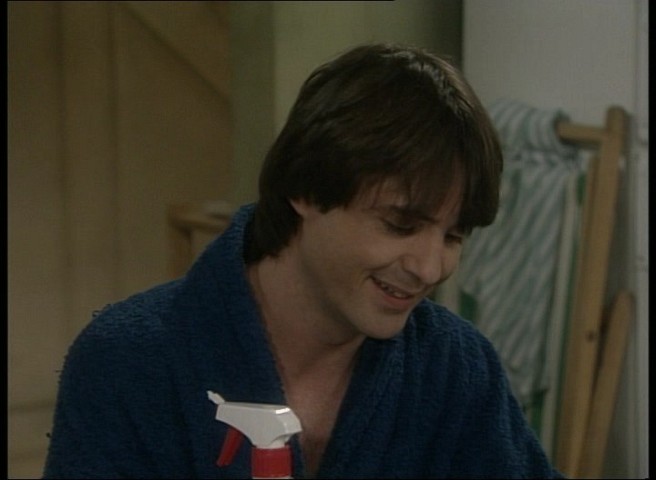

    If you take a 720x480 anamorphic video and crop ten pixels from the side and use anamorphic encoding to encode it at 710x480 the display aspect ratio will be correct. It'll be different to the original display aspect ratio because it has to be. You removed some of the "picture" (even if it was just crud). The shape of the remaining pixels doesn't change though. Look at it this way:
    If 720x480 = 4:3 and you crop half the width, what's left is 360x480 and the output aspect ratio is 2:3. The remaining picture won't be distorted at all. Zero% aspect error, but there'll only be half of it assuming you're using anamorphic encoding. Nothing wrong with that, as such.
    If you're resizing to square pixels (no anamorphic encoding) you'd resize the above to (for example) 640x480 before cropping and 320x480 after cropping for zero aspect error.
    Mostly if you want to output 4:3 you're going to have to crop some of the picture that you normally wouldn't see due to over-scanning anyway.
    Wait till you come across a DVD which requires drastically different cropping throughout a single episode. You might find it'll require 12 pixels left, 10 pixels right, except for that scene in the middle where it's 14 pixels left and 28 right, and I've seen plenty of them. Normally it's not that drastic, so I scan through the video, find the section that requires the most cropping, and then crop the whole thing that way, even if it's a bit of picture a lot of the time. At least the whole thing ends up 4:3 and cleanly cropped throughout, but that's just me. I've also cropped many DVDs differently throughout because when the cropping difference is large for just a small section, I haven't wanted to crop away a heap of picture for the rest. So I'd use Trim() to do it like this, as an example. Different cropping for frames 3000 to 4000.
    Trim(0, 2999).Crop(12, 2, -10, -2).Spline36Resize(640, 480)\
    ++Trim(3000, 4000).Crop(14, 10, -30, -12).Spline36Resize(640, 480)\
    ++Trim(4001, 0).Crop(12, 2, -10, -2).Spline36Resize(640,480)

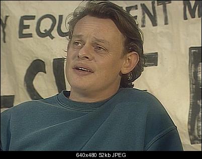

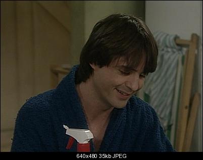

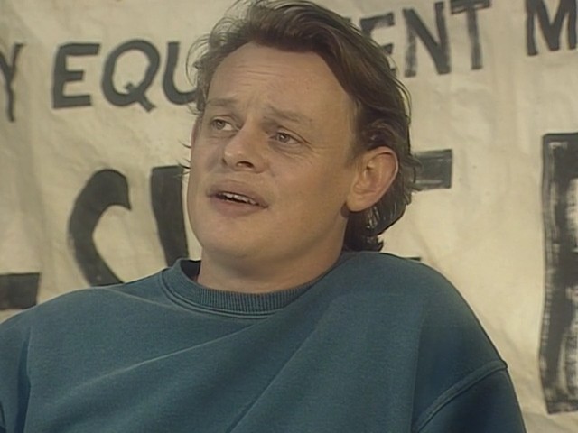

    Here's an example for you. Two screen shots from the original PAL DVD (resized to 656x480). Both pics are from the same episode. The cropping I used wouldn't have been far off the above.

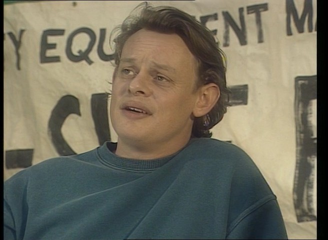

    How I encoded it. As you can see, I had to crop more picture to make the second pic 4:3 and remove all the crud (there's nothing forcing you to crop the same amount top and bottom, although I did in this case). Do I miss the cropped part of the picture? Nope. I'd rather have no crud. That's just how I'd do it though.......

    I totally understand your theory behind using a constant CRF value to maintain a constant level of quality for all your encodes, and yes even my method can be wasteful if I am assigning some videos more pixels then they need. My real problem is just maintaining the amount of hard drive space I would need to encode all videos at a CRF of 18. Part of my main goal in encoding was to keep my videos at a manageable size. I wanted then to be small enough to be portable and yet still maintain a good picture quality. Like I said, some "Scene" encoders try to do this also, but I just never felt there quality was good enough, so I following the same method, but just increased my bitrate to a higher number for improved quality (and improved upon their audio, but thats another story). I mean, my average encoded movie is probably around 2GB in size for around a 2 hour length. Encoding the same movie at crf18 would probably make a lot of them 4GB+ in size. Not only is that a lot more space, but for example if I were trying to play one of my movies on a USB Flash Drive formatted to FAT32 then I could not even put a video over 4GB onto it. Of course I could solve that problem by formatting it to NTFS instead, but thats not the point.
    Just to test the theory, I just encoded 3 1920x1080 16:9 cartoons (no cropping needed as they filled the entire screen). The cartoons were only 8-9 Minutes long. I first encoded them using my method and goal Bitrate, then again all using CRF18. As you can see, the crf18 encodes are ridiculously large in file size for a 8-9 minute long video, whereas the ones encoded to my bitrate seem to be a more reasonable size for just a short video. However, I will admit that the quality was noticably better at some parts of the cfr18 encode when viewed on my Desktop Computer, however I barely noticed a difference when played on my TV.
    (Getting off topic for a moment, I do notice a lot more noise/pixelation/blocking in videos when viewed on my computer that I dont notice on my TV. Does that mean the decoder is better on my TV? I always keep MeGUI and my codecs up to date, but i test my videos using Windows Media Player and MPC-HC. I just built this Desktop a little over a year ago and its very powerful, so why would the picture look better on my 3-4 year old TV?)
    Anyway, back to what I was saying, here are the results:
    Video 1 (8m08s):
    cfr27.5 = 2,295Kbps = 147MB
    cfr18 = 18.0Mbps = 1.05GB
    Video 2 (8m11s):
    cfr28.5 = 2,408Kbps (just slighty above my norm) = 155MB
    cfr18 = 20.5Mbps = 1.21GB
    Video 3 (9m09s):
    cfr27.5 = 2,399Kbps) = 173MB
    cfr18 = 8,774Kbps = 598MB
    Video #3 was the only one that resulted in a "fairly normal" range when encoded at crf18, but still very high in size for 9Minutes of video. Video #2 was absolutely crazy! 1.21GB for 8 Minutes????? And 20.5Mbps is close to the original overall bitrate of a Blu-Ray Movie. You have to admit that is too much for only 9 minutes. Based on these numbers, how would you personally encode these 8-9 minute cartoons? Would you really still use cfr18 after seeing those numbers? By many people's standards even my resulting file sizes of 147-173MB are large for 8-9 min.

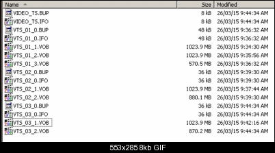

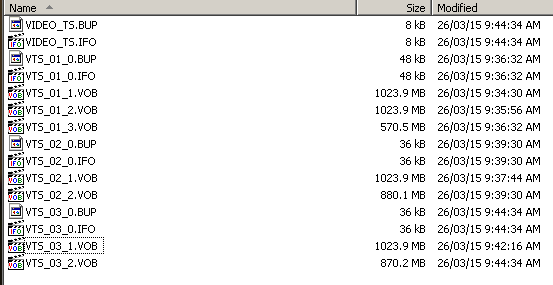

    Normally if a DVD is ripped "correctly" for encoding, you'll have a set of vob files per episode or a set for just the movie etc. You open the first in the set with the File Indexer and the rest will automatically be included when indexing and extracting the audio.
    When you open vob files for indexing MeGUI will use DGIndex. It's very reliable. When you open an MKV for indexing MeGUI uses ffmsindex by default. It's not quite as reliable for mpeg2 video. If you have any problems, try changing the indexing method to L-Smash in the file indexer. Me..... for MKVs with mpeg2 video I tend to open them with TSMuxer, remux them as TS files and then use the TS file for encoding as MeGUI will index those with DGIndex. The default indexer used depends on the file type, what's inside, and the formats each indexer supports.

    Lately when when I rip a DVD (considering I am focusing on Discs with multiple TV episodes), I have been using "DVD Decrypter" to extract each episode individually by the PGC #. Its the best way to do it since it keeps each episode separate from each other while retaining its own audio and subs. Then I usually just Mux the .vob file into a .mkv using MKVMergeGUI before encoding.
    As long as you're ripping correctly there's no reason why you shouldn't be able to open the first vob file in the set, and for DVD/mpeg2 video, it'll be more reliable indexing with DGIndex. In this case I ripped three episodes to the same folder (I use DVDShrink to rip and re-author at the same time), but you should end up with something like this. Opening VTS_01_1.VOB will give me episode one, VTS_02_1.VOB episode 2 and VTS_03_1.VOB episode 3.
    DVDShrink also has an option not to split the vob files into 1GB segments, although I didn't use it here. It makes no difference when indexing with DGIndex.

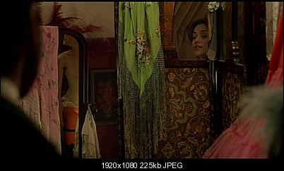

    I saved these as part of a discussion at doom9 recently, but here's a comparison between resizing a 720x576 16:9 PAL DVD frame to 1080p, vs resizing it to 1024x576 and then to 1080p, vs resizing it to 960x540 and then to 1080p. Spline36Resize each time. I'm sure newpball will be able to calculate the amount of theoretical information lost to five decimal places, but it's an example of why I personally look at the resizing rules more as guidelines.
    They're not encoded in between resizing, just resized, or resized twice as the case may be.
    720x576 to 1080p
    720x576 to 1024x576 to 1080p
    720x576 to 960x540 to 1080p
    I have also never heard of "x264 animation tuning". So I am not sure what it does or when or how to use it. Is that something i should be using for all Cartoons? Please let me know because believe it or not I do have some Simpsons episodes I will be encoding eventually as well.
    The tunings automatically change a few of x264's advanced settings. If you change a tuning and switch to the advanced tabs you'll see some of the settings change accordingly (check the deblocking strength to begin with). The same applies to changing the speed preset. I use the Film tuning most of the time as it'll retain a bit more fine detail than tuning "None". It'll also increase the bitrate a bit for a given CRF value (there's no free lunch). The animation tuning kind of does the opposite and is for animation with large flat areas of colour (Simpsons type animation).

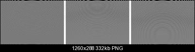

    A - Original 1440x1080
    B - A resampled to 720x480
    Video shows:
    - A Original
    - B resampled to 720x540 and then resampled again to 1440x1080
    - B resampled to 640x480 and then resampled again to 1440x1080
    Make sure you explicitly select 1080p before you watch the video.
    Some details comparing the original, 720 and 640 version
    One wonders how those "purists" convert 720x480 straight to 1440x1080?
    Straightforward would be 2*720 and 2.25*480.
    I suppose the purists prefer first to cripple the horizontal resolution to 640 and then rescale 640x480 to 1440x1080.

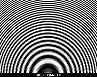

  28. Nice irrelevancy there newpball.

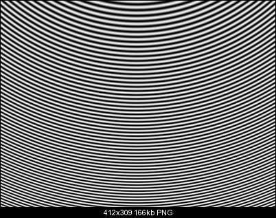

    What we're talking about is taking an anamorphic image:

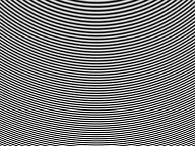

    And resizing it to square pixel dimensions like this:

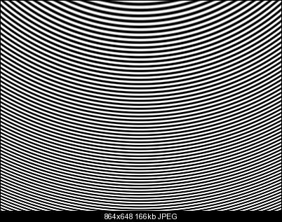

    Despite your complete confidence the sky will fall on our heads if we don't resize it like this:
    Then we resize the second image to 1080p on playback
    (really 864x648 to keep it to scale with the original):
    And the third image to 1080p on playback
    We all know the theory, but show us a real world example of a 4:3 NTSC DVD image that doesn't look as good resized to 640x480 as it does resized to 720x540. You do remember that's what we were talking about?
    I could show you example after example of resizing and the effect it has (or not) and you'll just continue to ignore them if they don't suit. Is there a noticeable loss of quality due to my resizing the PAL DVD image down a little before resizing it to 1080p in my previous post, or are you going to continue to ignore examples offered and continue to be irrelevant as a result?
