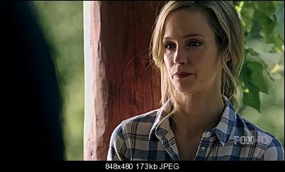

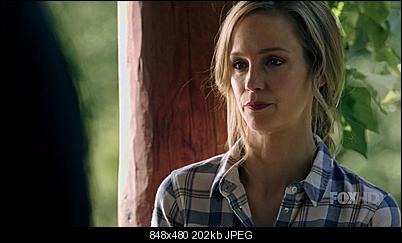

    Nvec h.265 is twice as fast as Nvenc h.264, 252fps vs 132fps with this video and with better compression using CQ and the same settings, although with VBR h.264 could produce better compression but not by much. And then lastly looking at the resulting video, the h.265 was slightly sharper with more detail.
    Here's the results of two Nvenc h.264 runs, the first is CQ with the same settings as h.265, the second VBR.
    NVEnc 1.10 (x64), using NVENC API v5.0
    OS Version Unknown (x64)
    CPU Intel Core i7 950 @ 3.07GHz [TB: 3.11GHz] (4C/8T)
    GPU GeForce GTX 970 (13 EU) @ 1177 MHz (355.98)
    Input Buffers CUDA, 16 frames
    Input Info y4m (yv12) -> nv12 [SSE2], 854x480, 959/40 fps
    Output Info H.264/AVC high
    854x480p 1:1 23.975fps (959/40fps)
    Rate Control CQP
    CQP I:20 P:23 B:25
    GOP length 240 frames
    B frames 4 frames
    Ref frames 3 frames
    MV Quality Q-pel
    CABAC/deblock cabac / on
    encoded 61653 frames, 132.98 fps, 1658.22 kbps, 508.33 MB
    encode time 0:07:44 / CPU Usage: 0.97%
    frame type IDR 257
    frame type I 257, avgQP 20.00, total size 7.92 MB
    frame type P 12331, avgQP 23.00, total size 142.80 MB
    frame type B 49065, avgQP 25.00, total size 357.61 MB
    finished after 00:07:45.517
    Created C:\test.x264 (508.332 MB)
    Rate Control VBR
    Bitrate 1100 kbps (Max: 2000 kbps)
    Initial QP I:20 P:23 B:25
    VBV buffer size auto
    B frames 4 frames
    Ref frames 3 frames
    MV Quality Q-pel
    encoded 61653 frames, 135.75 fps, 1108.96 kbps, 339.96 MB
    encode time 0:07:34 / CPU Usage: 0.80%
    frame type IDR 257
    frame type I 257, avgQP 22.44, total size 6.14 MB
    frame type P 12331, avgQP 24.09, total size 111.96 MB
    frame type B 49065, avgQP 27.49, total size 221.86 MB
    finished after 00:07:36.695
    Created C:\test.x264 (339.956 MB)
Name:	NVEnc h.264 vbr - 678.jpg
ID:	33870Click image for larger version
  6. @ValenNC -
    I wonder if something is misconfigured for your AVC runs ? Are you performing other operations ?
    You should be getting 400-800 FPS at SD . You get ~200 FPS at 1920x1080. You're testing 854x480 only - that suggests something is wrong with 130-135 FPS
    To put things into perspective x264 using --preset superfast is even faster - you should get about 350-450 FPS at that resolution on a modern quad core . There is no way NVEnc should be slower than CPU encoding

    To me the top pick looks a little less detailed than the bottom one (referring to post #29 and NVEnc vs x265), but at 480p it's possibly nitpicking considering the difference in encoding speed.
