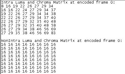

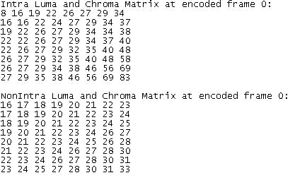

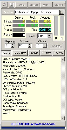

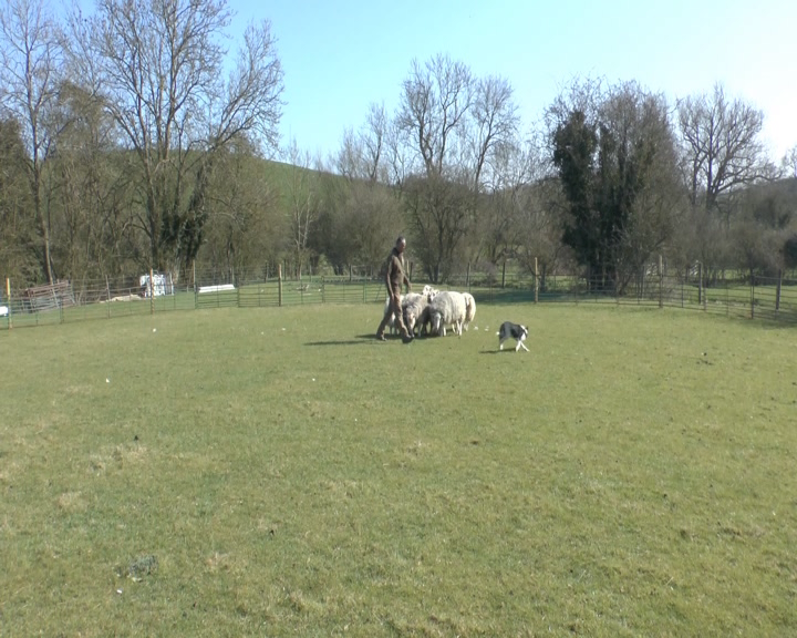

  8. Since pdr said you can't adjust a lot of the settings, then why not switch to using a different and better encoder, one such as hank315's HCEnc?
    I can't explain most of the differences but can point out that the information bears out that the MainConcept result is definitely inferior to that produced by Apple.
    The first two pictures are from your MainConcept encode, the lower two from Apple's encoder. The most striking thing to me is the huge difference in the quant values (the Q-level). The MainConcept one at 10.14 is guaranteed to produce mosquito noise and macroblocking while the Apple one is quite low.
    One explanation is that the different encoders use different quantization matrices and hank315 earlier criticized the one MainConcept uses. I don't much like either matrix but the one Apple used is certainly preferred when the source is hard to compress. I don't use either encoder but am fairly sure you can't choose to use a different quant matrix. But that won't explain the entire difference. The higher max bitrate employed by the Apple encoder (9000 .vs 8000) allows the more complex movements to get more bits. That's an important factor. In addition, the MainConcept encoder encoded a progressive stream using Alternate Scanning and the Apple one used the preferred ZigZag Scanning. Apple used a lower DCT Precision (8 .vs 9). But those are fairly minor. There are other reasons, probably some of the ones hank315 pointed out earlier, ones over which you have no control.
    Again, I'd suggest using a different encoder.

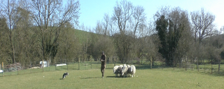

  10. Member Skiller's Avatar
    Oct 2013
    Germany
    Thanks for that lossless sample, I had some fun with it.
    Here's my result at downscaling and encoding it.
    I used a custom AviSynth script with linear light resizing in 16 Bits, low-pass and a slight FineSharp to carefully bring out a little more grass details.
    Encoded with CCE SP3 with Manono3 Matrix and and an average Bitrate of 5700 Kbit/s (max 9200, min 2500, although the sample is too short to have much of a fluctuation). Personally I would try to use a higher average bitrate because the video is so detailed but I used 5700 here because it seems to be your required average bitrate.

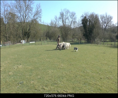

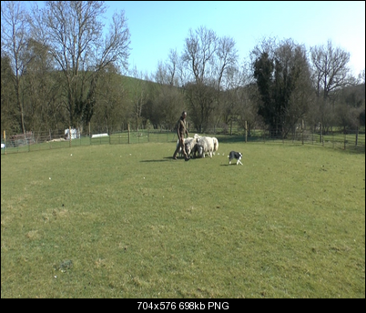

    I noticed the levels seem to be wrong in your Apple Compressor sample.
    Apple Compressor
    Me
    The levels of your Premiere export are the same as mine, so it's quite obvious Apple messes it up somehow.

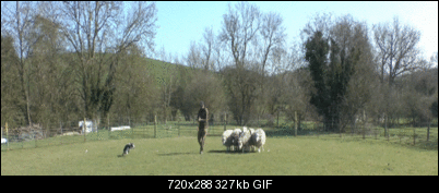

    I also noticed there seems to be no low-pass at all with both of your encodings which results in heavy interline twitter (jaggies) whenever it's played back through interlaced playback chains. Here's an approximate simulation of what that would look like:
    The Premiere MPEG2 encoding is horrible (despite >7000 Kbit/s in that sample!) but the actual downscaling is better than Apple Compressor which is rather blurry. Also, Apple scales 1920x1080 to 720x576 (rather than 704x576) which both I and Premiere consider wrong (hence the small black bars in the Premiere encode).
