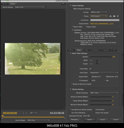

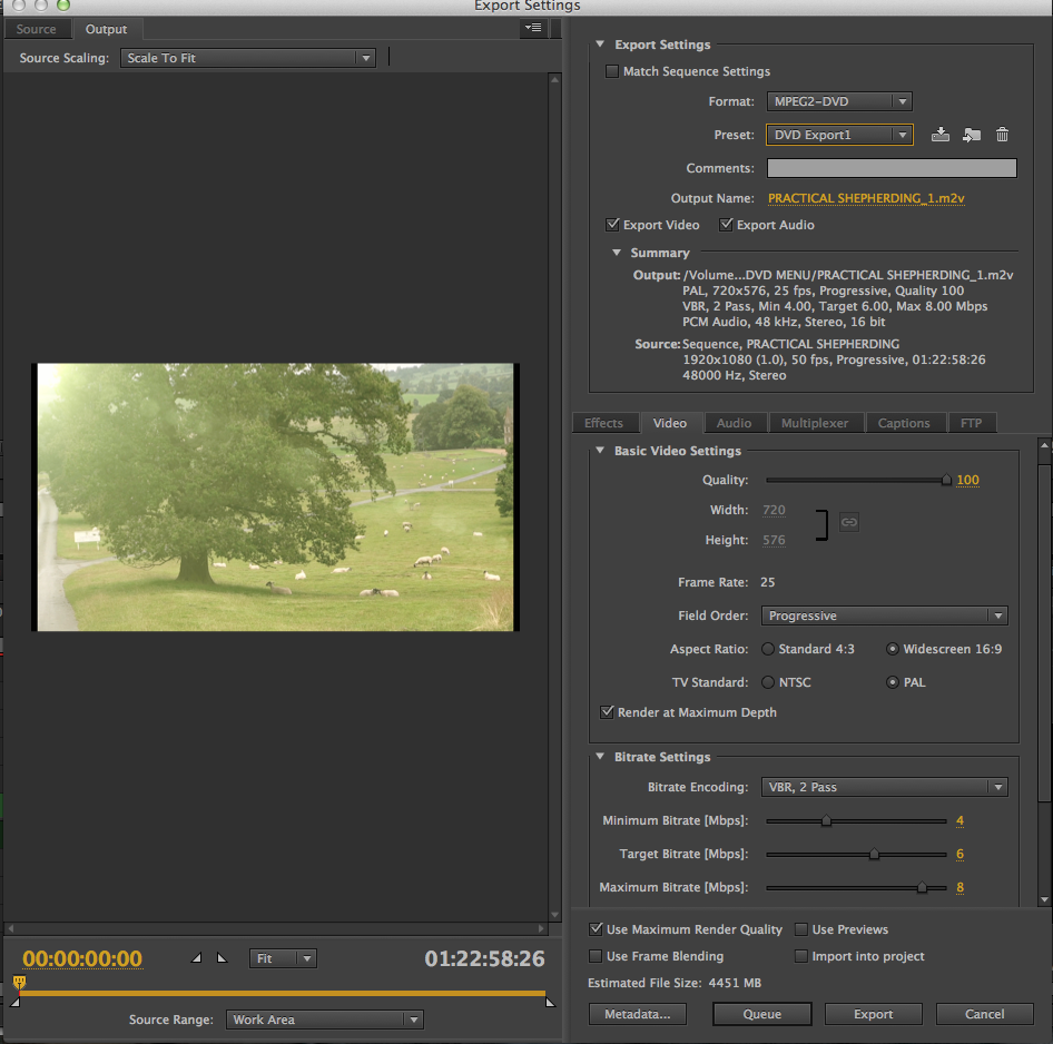

  1. I am getting awful quality after my exports from Premiere Pro CC using the mpeg2-DVD option (See examples below.) Please help! I know DVD's use a low resolution but surely the quality can't be this poor! Scene's with a lot of motion are particularly bad - movement causes pixelation and distortion. I am thinking there is possibly a problem when Premiere scales my project from HD to SD.
    My export settings:
    My sequence settings:
    Timebase: 50fps
    Frame Size: 1920 x 1080
    Pixel Aspect Ratio: Square Pixels (1.0)
    Fields: No Fields (Progressive Scan)
    Preview File Format: P2 1080i-1080p 50Hz DVCPROHD
