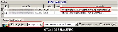

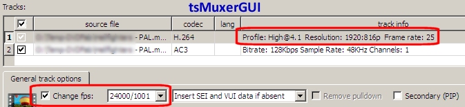

    1) Using tsMuxerGUI, Demux the video stream first (be sure that ONLY the H.264 video stream checkbox is checked). Note that the H.264 video file has a framerate of 25 fps.
    Click on the Change fps: box to 24000/1001 (23.976 fps). Click on the Start demuxing button. This should take < 1 minute. Using tsMuxerGUI for the framerate conversion is the simplest and very fast way. There's no re-encoding. It just changes the frame timing synchronization. Done!

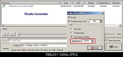

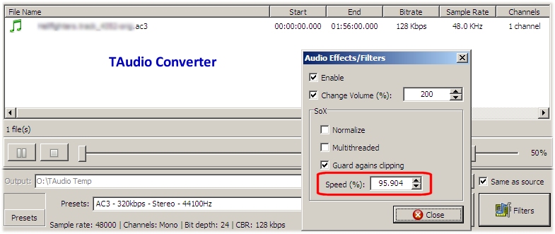

    3) Once loaded, the example original PAL audio file shows a time of 1:56, but in actuality, it should be about 2:01. As shown below, to change the timing, click on the Filters button, and the Audio Effects/Filters options box will appear. You need to reduce the "speed" of the audio file by setting the Speed (%): to 95.904 (23.976 fps / 25 fps). In this dialog, you can also set the volume, and if necessary, set the clipping guard ON. Press Start to begin the speed conversion.
    Note that you may have to tweak some of the Presets: settings to suit your individual needs. The conversion takes about 2 minutes.
