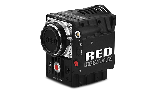

    Originally Posted by underthemountain View Post
    Neat! I didn't know that they made 6K cameras.
    It's a beauty:
    But some still prefer to work with this kind of material, they'll never learn!
  18. But man, did that second one sit nice on the shoulder.

  20. ...I meant to say without adding semi-ergonomic pointy twiddly bits. Using the red (any red) for run and gun documentary or news is still a huge PIA. Undeniably nice picture if you have the time to fiddle.
  21. Yes, the two camera bodies are for completely different usage scenarios . You'd have to add weights to counter balance the rig on the Red. The post workflow for Red is not conducive for ENG style scenarios which require fast turnaround
