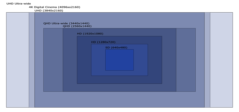

    Is there absolutely nobody on this forum who shares my sentiment. You buy a 4k camera, record 4k and then out of 'respect' for your customers you force them to only see it in SD? And then on top want advice on improving 'quality'?
