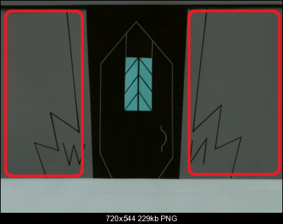

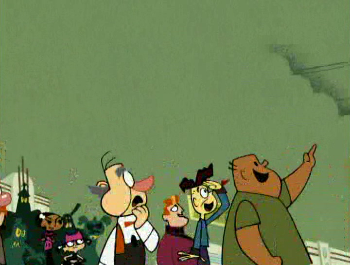

  3. chroma.mkv
    After using my script (or any other strong degrainer/denoiser I've used), the background color gray somehow flickers (the red boxed area). This isn't very noticable on my computer, but it is very on any other device (lcd tv, crt tv, laptop, tablet, phone). Looks like Cnr2 reduces the flickering a bit, but not ideal.

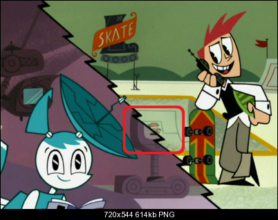

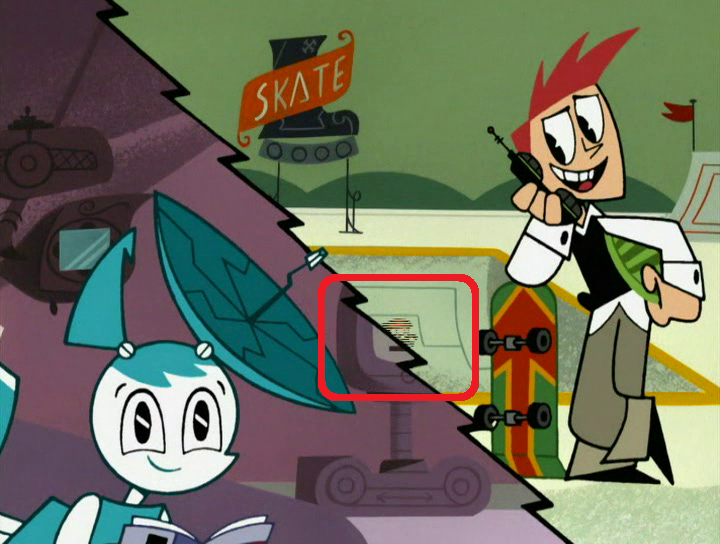

    lines.mkv
    In this frame, there are some lines in the middle of the screen (see the red box). QTGMC didn't get rid of it.

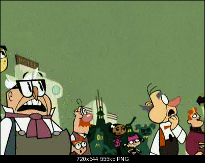

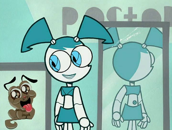

    morelines.mkv
    When speaking, this sometimes happens. Again, QTGMC didn't get rid of it.

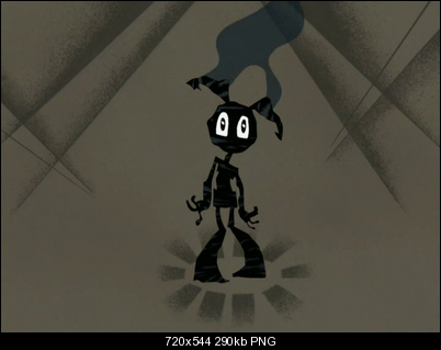

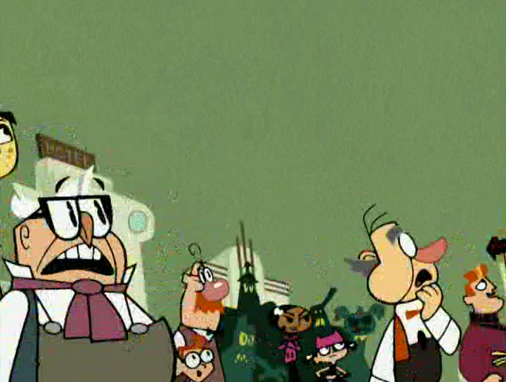

    movement+chroma.mkv
    These artifacts occur during movement.

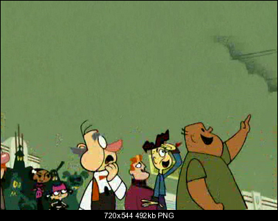

    And the background flickers again, like with chroma.mkv. It looks again like Cnr2 reduces the flickering.
