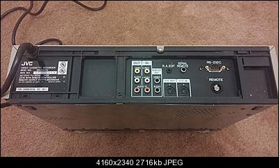

    Also, I was wondering if it is worth switching from composite to S-Video. I might have to buy an S-Video cable. My Ezcap has an S-Video port, and so does my Hi8 camcorder and S-VHS VCR (I think).
    It might help a little. It can reduce dot crawl, and you might get slightly better color, because the hardware doesn't have to try to extract the color carrier from the composite signal. However, this is minor compared to the other issues, and I'd put that off until you have everything else working.

    I am going to get the S-Video cable because I think it will help a little.
