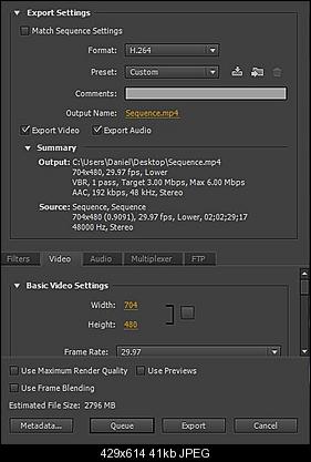

  11. Click image for larger version

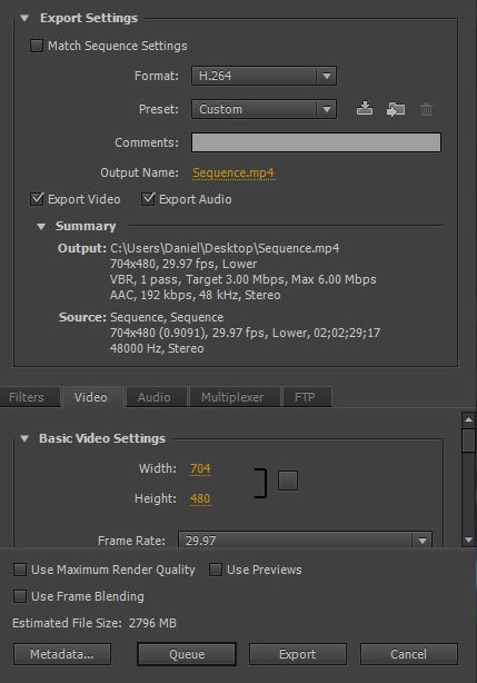

    Where is Sequence.mp4 from ? How did you get it? What is the workflow history ?
    Yuu didn't post your sequence settings.
    If you match sequence settings in premiere and AME, the input should be similar as the output (no duplicate frames or fields) .
  15. I tried switching it to upper first, but no difference.
  16. Did you try adjusting the sequence settings as well ? Upper for sequence settings, upper for export settings (both), and interpret the file as Upper as well (right click the clip) . Premiere might be "guessing" the wrong field order because it's encoded Bottom field first, but the content is Upper field first
  17. That solved the problem. I forgot to change the sequence settings. Actually, I couldn't change the sequence settings; I had to create a new sequence.

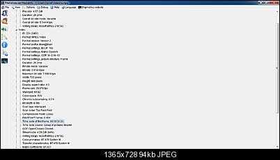

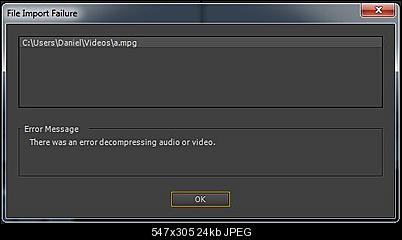

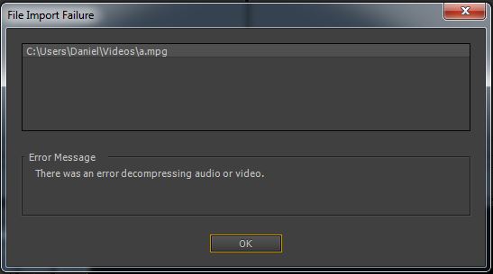

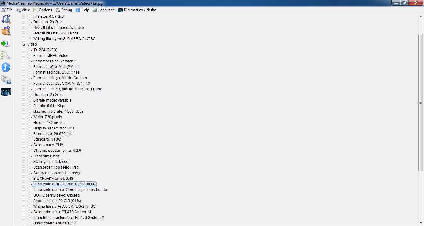

  28. What's wrong with keeping the original MPEG2 format that you captured in? Why is it VFR in the first place ? Are you sure ? Most captures will be CFR, unless they are webcam variety
    Oh, nevermind. I am thinking of the Elgato capture device I had. That was variable framerate. However, I had to get rid of it because it wasn't compatible with a lot of capture software. The software included with Elgato would deinterlace and apply filters automatically, with no manual controls.
    The reason why I converted from MPEG-2 to some other format in Handbrake is because Premiere Pro CS6 doesn't work well with MPEG-2.
    Premiere Pro CC is giving me problems with flickering lighting when I stack multiple effects on clips.
    MPEG-2 is also lossy by the way.

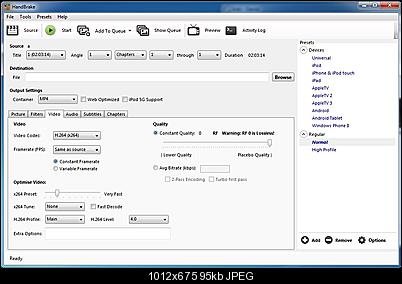

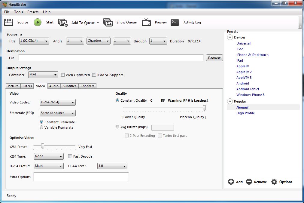

  29. If you absolutely have to create an intermediate that works with Premiere Pro, can't it be a lossless AVI?
    What about lossless H.264? Set the quality slider to 0 in Handbrake.

    Yes it's lossy. But that's considered your "original" , since you're not going to upgrade your capture setup.
    The point is you're not incurring ADDITIONAL, AVOIDABLE quality loss .
    You would have to set the profile as well, or handbrake will actually use "1" (not lossless). The filesize will be 5-10x the size as the original, and not be supported by premiere (PP doesn't support x264 lossless). So you should use the original if you can
    Try re-wrapping the captures, either into another program stream (e.g. with ffmpeg) , or into a transport stream with tsmuxer
