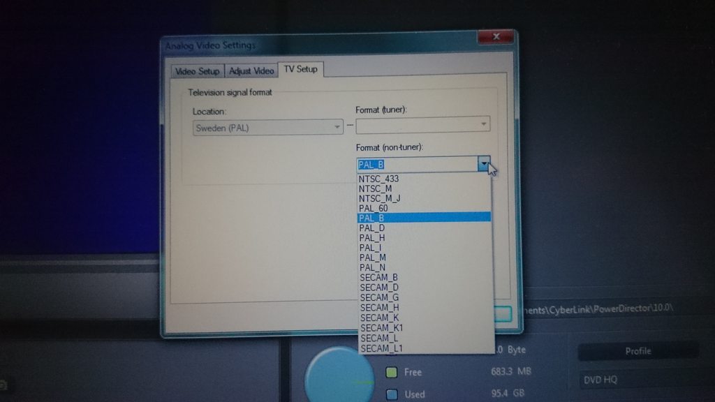

I tried VirtualDub to see if there was a software issue, but nope. I selected different regions (PAL-B, PAL-G etc, I am located in Sweden btw), no difference.

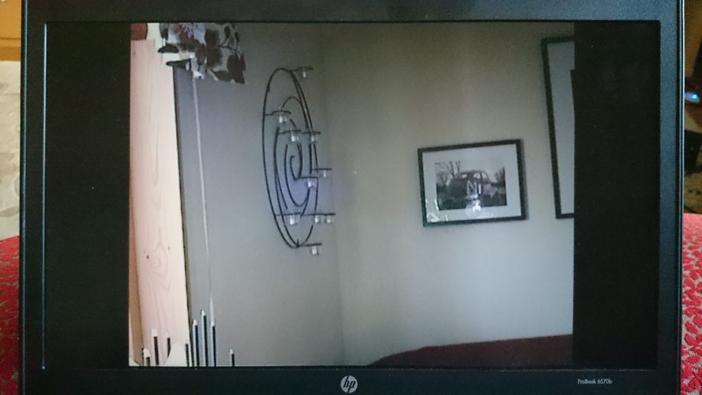

Captured from the camera while it was recording to the tape.

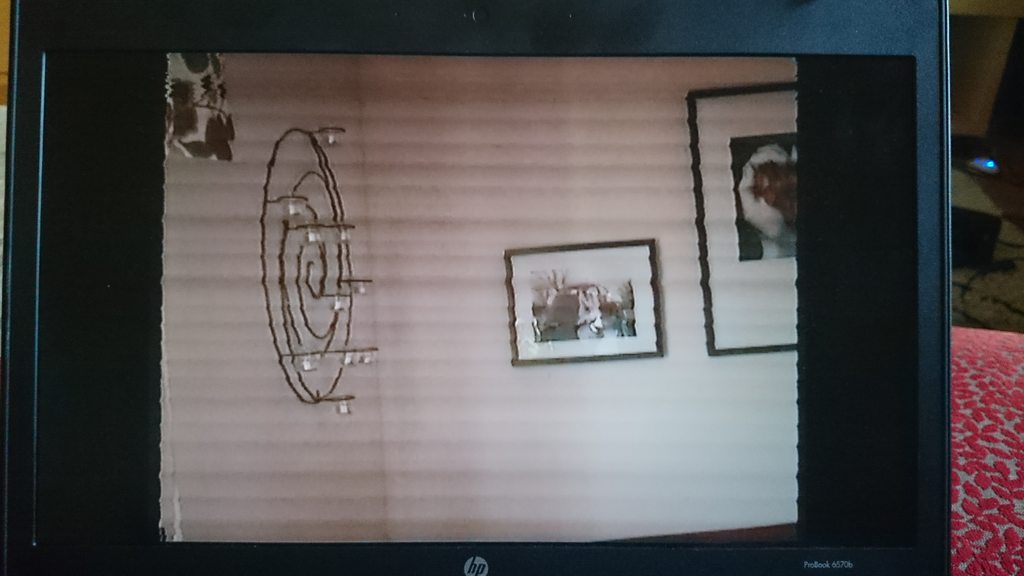

Playback

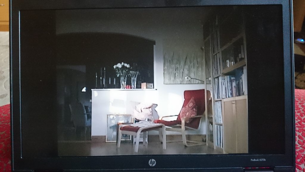

Captured the video stream while recording

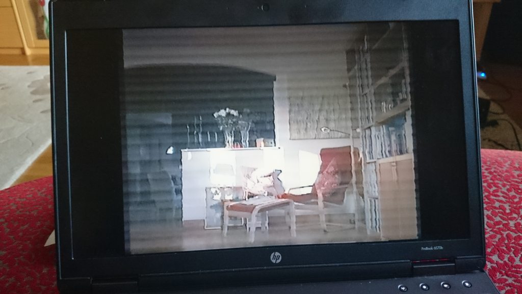

Playback

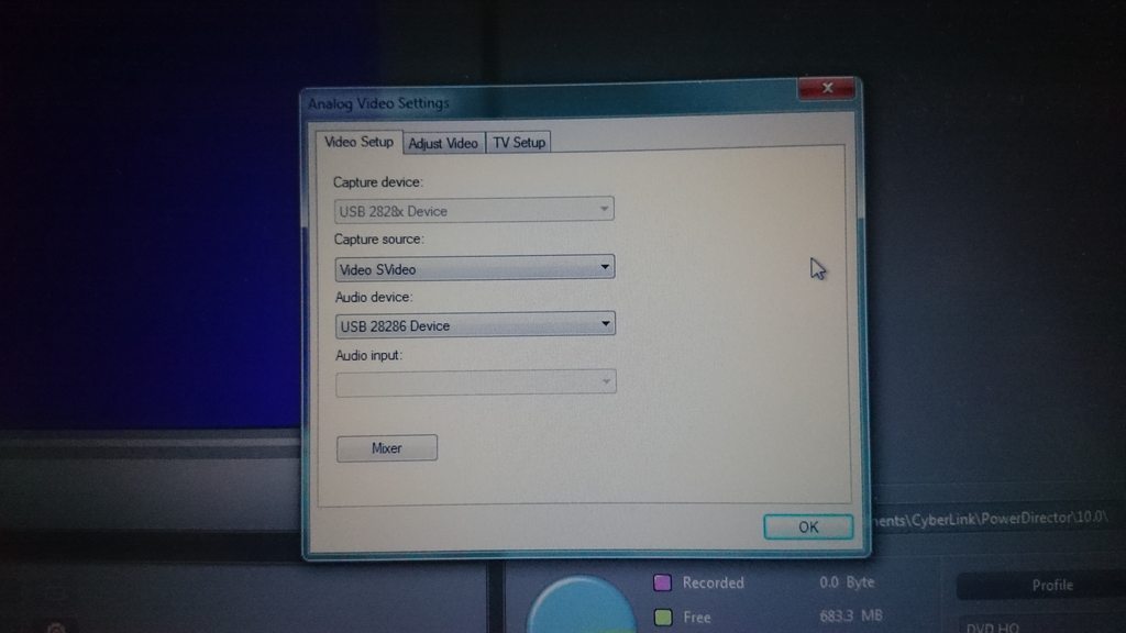

Very bare bones settings for the capture device
So your Moviesaver doesn't like the Handycam signal on playback. Does the Moviesaver have any problem with other s-video devices? What happens if you play the tapes on a different Hi8 deck?
Hey thanks for the replies.
You mean the signal might be different depending on if its playing back recorded video or just showing the "live stream"? Interesting.
We only had two different Sony cameras to play back the videos. No other equipment.
The heads have probably never been cleaned. It is not my equipment. By the way the playback was perfect when we tried it on his Samsung TV.
