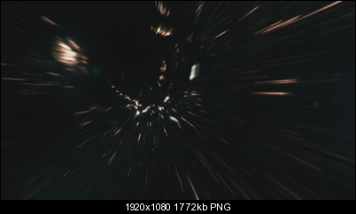

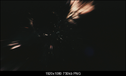

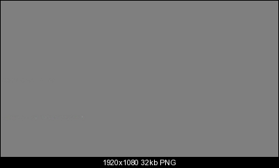

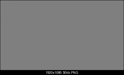

  1. At seemingly random intervals, Vegas 13 inserts these gray frames with noise in them into Blu-Ray footage. Sometimes there are 2-3 instances, this time there were 4. I'm using Pismo File Mount Audit Package to virtualize my AVS file into a readable AVI. The AVI reads perfectly (no gray glitch) outside of Vegas. I have disabled GPU rendering. I have unmounted and then remounted the AVS file. Sometimes, in the middle of the gray frames, there is a jumbled frame or two from another part of the footage.
    Has anyone seen this before? How did you overcome it?
