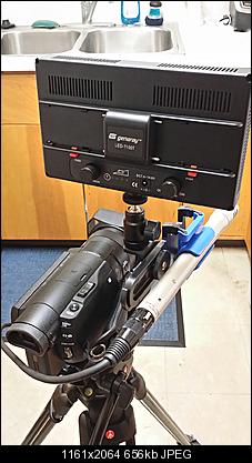

    Here's a pic of the Shure 81 mic.
  3. Your camera external mic input will provide the low voltage 'plug in power' required for electret condenser mics, but I doubt it has the 12-48V 'phantom power' which the Shure 81 needs....
