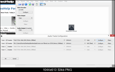

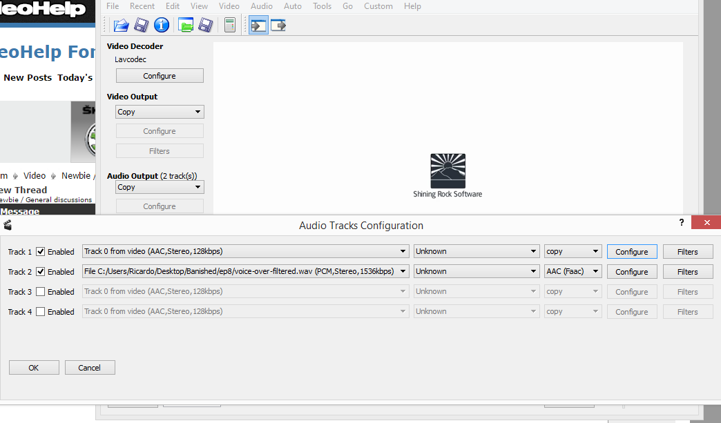

    im having some trouble with avidemux
    i have an mp4 video file with an acc audio track which i need to have added a wav file (and convert this wav it to acc) all in avidemux
    can it be done?
    avidemux is not bothering with the wav file and exporting the mp4 with only its original audio track.
    can inot package the mp4 with an aac and a "to-convert" wav?
    regards

    ive added pcm wav audio to at least 7 mp4 videos in the past week with avidemux
    what are you talking about?
    its get then converted to aac
    but adding a wav to be converted to aac doesnt work when the mp4 already has one other aac
    did you not see the encoding for the wav in the image?
