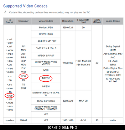

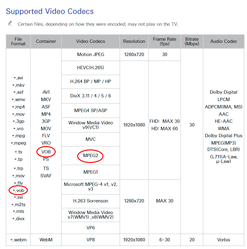

    I think you are mistaken, according to the manual vobs with MPEG-2 are supported.
    Make sure you rip the disks as opposed to simply copy the VOBs.
    VObs may not be ideal for you and you certainly can mux MPEG-2 streams in other containers. You probably would need to do a bit of trial and error. Transcoding (converting to another compression format) is really the last thing you would want to do.
    Unless of course you do not care about quality.

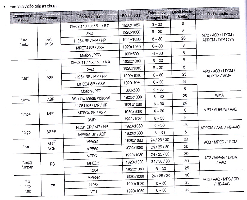

    The table in my TV's manual is not the same as yours.
    The .vob files do not appear in my file extension column.
    But I think you are right, these DVDs were made with a good quality and it would be a pity to downgrade this quality. And the idea I should retrieve the MPEG2 streams in my VOBs and repack them in one of the approved containers sounds good to me, if the VOBS cannot be read.
    But with what software ?
    The fact is I simply copied the VOBs from the DVD. The TV does not "see" these files, i.e. they are not displayed when selecting the video to display. This means that the TV decided it was not a suitable format.
    What do you mean "rip the disks as opposed to simply copy the VOBs". I do not understand what the difference is ..
    Gabier

    It's not my TV I pulled the manual based on the model you gave me.
    And it does support it, is it simply the filename: *.vro / container: VOB / codec: MPEG-2
    You may have to remux the vobs to vro.
