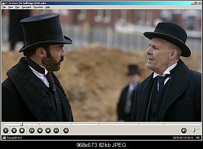

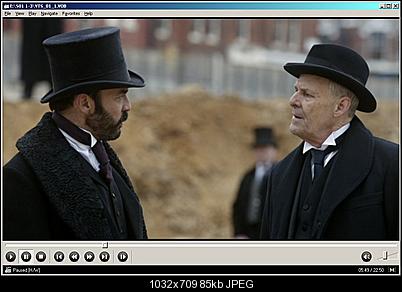

    I can take a DVD video (mpeg2) and re-encode it with the x264 encoder and dramatically reduce the file size. Every time. Take the last three episodes of a TV series I encoded today as an example. Only one audio stream, which I copied. Source vob file total sizes 2.5GB, 1.8GB and 1.8GB. Input resolution 720x576. Output file sizes, CRF18, 832MB, 634MB and 608MB. Output resolution, 960x540, so the pixel count increased a little. I'd probably need to encode those at something like CRF14 to have a chance of not reducing the file size. Not only didn't the blocks overlap, but I changed their shape, yet taking video compressed with a less efficient codec and re-encoding it with a more efficient one reduced the file size. Is there a special Xvid property with stops the same principle from ever applying?

    Original DVD video:
    Re-encoded version at one third the file size:
    This one's a bit harder to pick but close examination should show the re-encoded version looks a tad better.

    Can you see a quality reduction in the screenshot of my AVI to MKV conversion? I was hoping you'd point out where you can see the quality loss.
