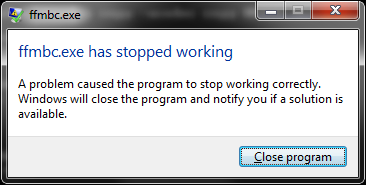

  1. Can someone please tell me if ffmbc can handle rewrapping 5.1/6 channel AC3 audio into a Quicktime container using AAC audio? For example, if I have an MP4 with stereo AC3, the following works like a charm:
    ffmbc -i input.MTS -vcodec copy -acodec aac -ab 256k -strict experimental input.mov
    However, if the video contains 5.1/6 channel AC3 audio, the code above chokes hard. One work around I have found is to just demux the TS.

  3. Yes, it crashes. It probably can't do 6ch audio with aac
    You could use ffmpeg to do it (it doesn't crash), but there is something "magical" about ffmbc's muxing that makes things go smoother in programs like NLE's
    If space is not an issue, use uncompressed audio
    ffmbc -i INPUT.mts -vcodec copy -acodec pcm_s16le OUTPUT.mov
    or You could do it as a 2 step batch file, using a better aac encoder , like QAAC or NeroAAC, by piping ffmbc to it, and muxing that output with stream copied video. You usually don't want to use ffmpeg / ffmbc's AAC encoders (libvo_aacenc , faac, libfaac, etc...) anyways (quality is quite poor) . Although you can build ffmpeg/ffmbc with libfdk_aac, they are not distributed with it because of licensing /legal issues. The "best" AAC encoders are probably quicktime (QAAC), FDK_AAC, or NeroAAC

    Chokes as in:
    I have tried ffmpeg and it works but as I mentioned in my OP, ffmbc seems to be the preferred tool for rewrapping AVCHD to Quicktime per https://code.google.com/p/ffmbc/. However, you are correct that my MTS has multiple audio streams. As I mention in the title, my video is 5.1/6 channel AC3 audio. And trying to convert that to AAC causes the crash above.
