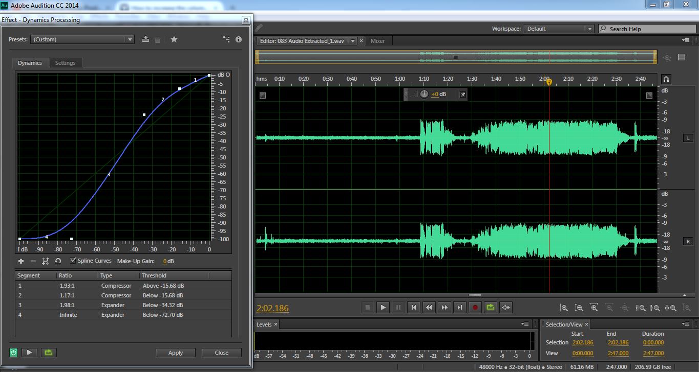

  6. This is what I want to do:
    I just don't want to expand the dynamic range too much so I don't hear the audio fading in and out. What I have it set to right now seems to work, but I don't have a trained ear. I know noise reduction is in my toolbox, but this kind of noise is too difficult to remove well. I don't want to get rid of it anyway.
  7. Can you post the actual audio represented by the timeline you posted?
    My preference would be to use a noise reduction plugin (I own iZotope RX). I think you will find that any sort of dynamic range manipulations that are strong enough to reduce the noise will start introducing pumping or other artifacts.
