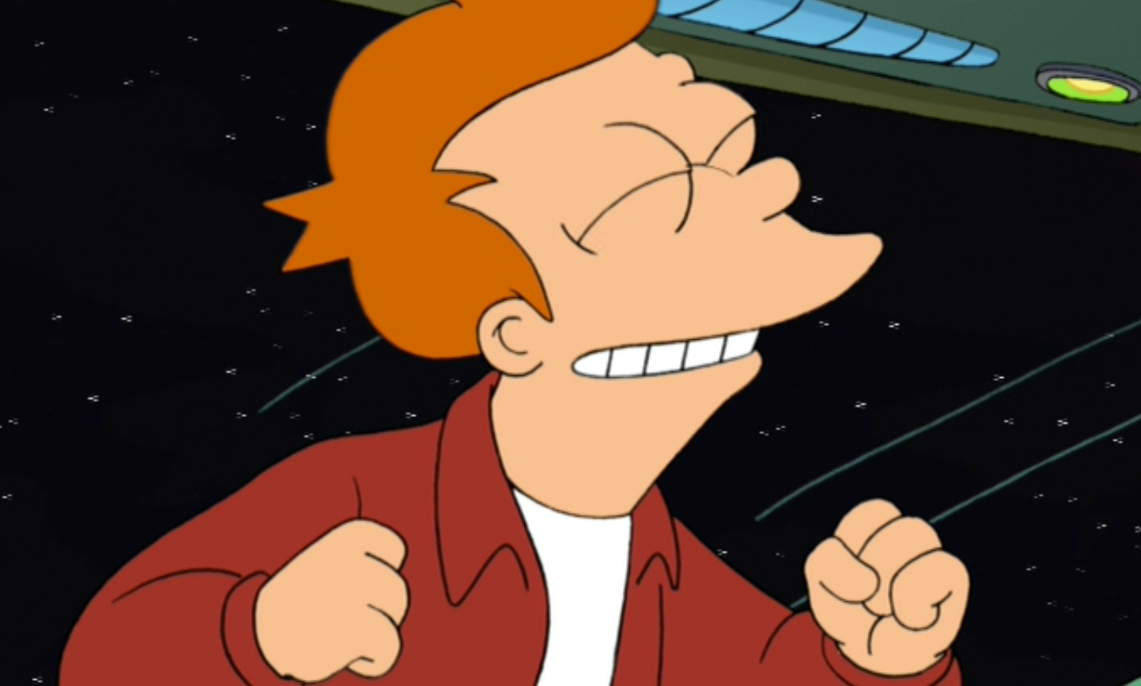

And thank you you checking that for me. Looking at the DVD, I think it's simply due to the sources and that nothing can be done - horizontal scrolling just doesn't really play nicely with interlaced content, if you take a look at this frame, specifically the stars, you can see where the problem comes from:
[Attachment 75046 - Click to enlarge]
The encodes are such a huge improvement, I just was worried I'd messed them up somehow!
