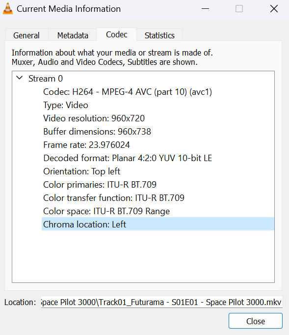

    Does this info look correct to you?
    (I know nothing about why the buffer is smaller than the video size)
    [Attachment 74982 - Click to enlarge]
    I've only done the one file so far, but I have to say it's a good deal better than the straight rips already!
  8. Excellent job scoring the missing plugins! Seriously. And the info looks correct; do you have MediaInfo available? The Futurama profile is for Futurama so it's surely the choice .

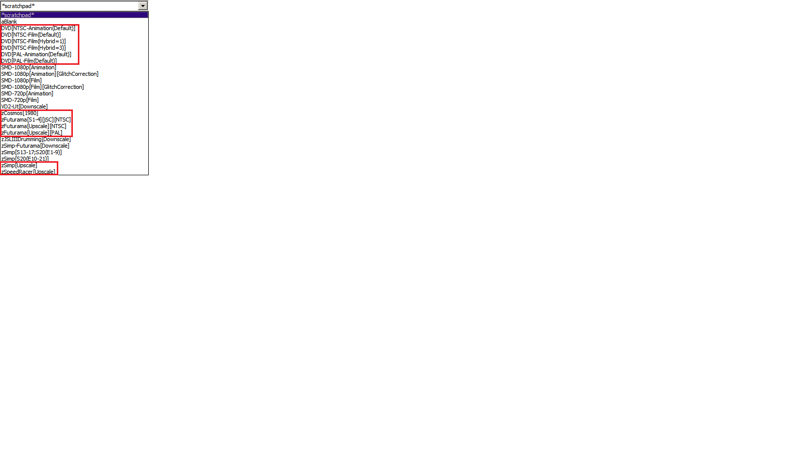

    I have it sorted out now, thanks. In case you use them, these other profiles would need to have those two boxes unticked also:
    [Attachment 75004 - Click to enlarge]

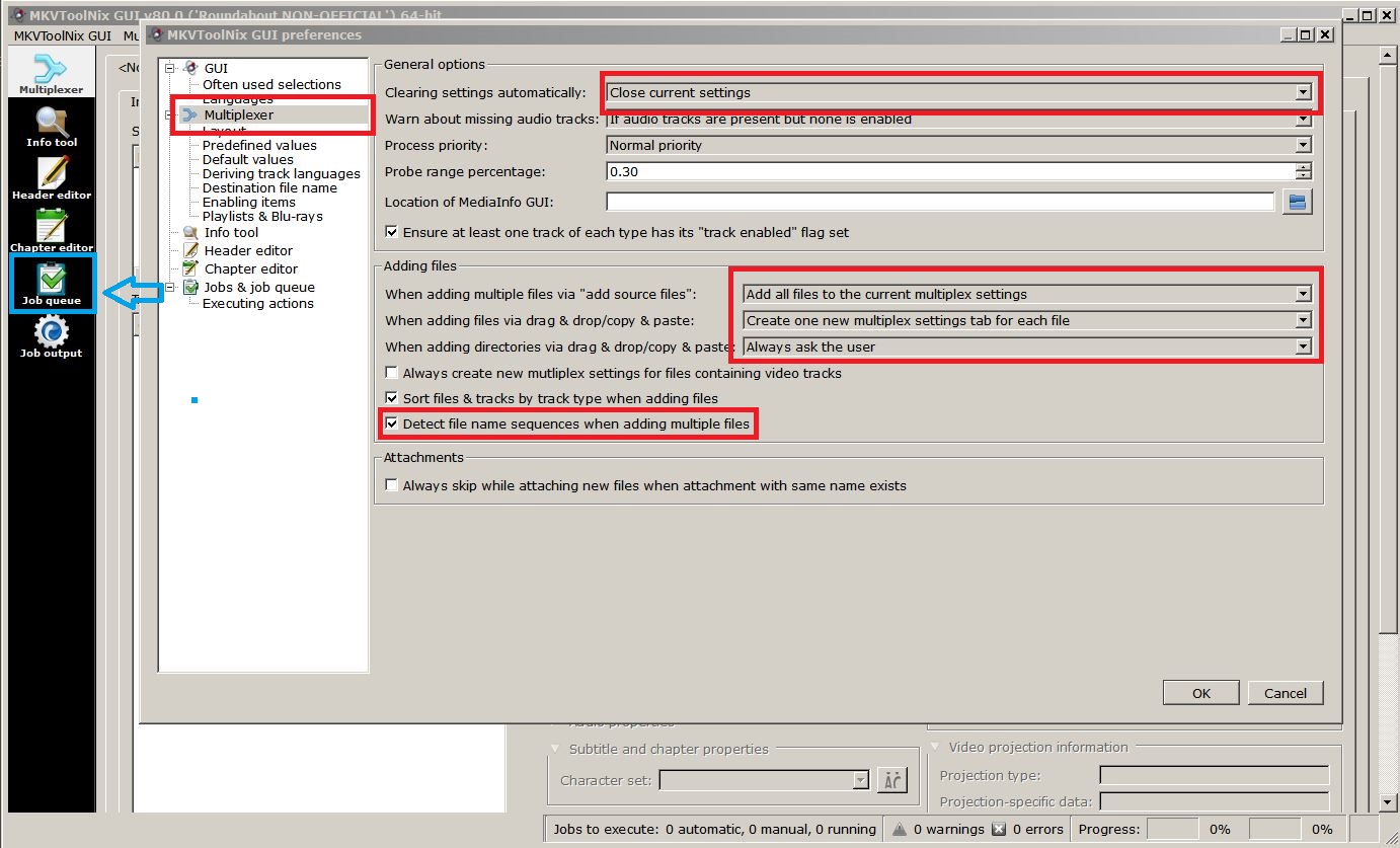

  26. Honestly, it took a bit of effort to understand the the new, far more functional MKVToolNix GUI; I was running 8.3.0 because it's way less busy until I made the switch around 56.0.0 or so. And once you get the hang of it it's brilliant. Here are several important settings to consider in red boxes and the blue box is the job queue.
    [Attachment 75024 - Click to enlarge]
    I've a programmable mouse and found that incredibly helpful. If you already have a method to name things to your liking, then there's no need to worry about which file to add first because MKVToolNix is smart enough to always place video first even if it's added last; however, as I suggested earlier, I would highlight the two audio tracks at the same time then drag & drop with the cursor on the main audio; that way it'll populate first and be the default audio track. Before trying to queue all your episodes for muxing I'd highly recommend fiddling about was a couple-three episodes until you understand the possibilities and you're happy with your method of loading, queuing, muxing. I like my settings on the MKVToolNix I uploaded for you for batching jobs but you might not.
