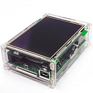

    How about getting the Raspberri and then a transparent case + monitor as an add on:
    http://www.amazon.com/JBtek-Raspberry-Transparent-Included-Software/dp/B00L15FOF4/ref=...ry+pi+2+screen
  19. Member ahhaa's Avatar
    Feb 2005
    Michigan USA
    Newpball- uhmm, the price looks OK as far as saving time, tho it is described as a kit; but I just got my Pi Model 2 so I noticed something- that video jack is orange, mine is black and none of the photos seem to show the mobo end with the USB ports.
    You'd want the model 2, it is 6X faster and has 4 well-juiced USB ports (all for the same price) aligned with the Cat5 off the unshown end of the mobo. (Earlier boards only had two USBs.)
    It may not be an issue, or it could be a case for a prior model Pi. They are very similar but not identical.
    You should ask and be sure that screen is OK with the 2- it most probably is...
    also go to http://www.raspberrypi.org/community/ for more connections to useful info.
  20. Banned
    Oct 2014
    Northern California
    Oops, I just looked at the bad reviews, for sure I am going to skip on this case/display combination.
