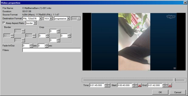

  10. I too would use either VOB2MPG or MKVMergeGUI to create a single file.
    And then I would merely use that 3 times in DVDStyler and trim each (if it needs to be titles and not merely three chapters - you could have the same navigation on a DVD using chaptres?)
