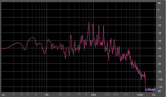

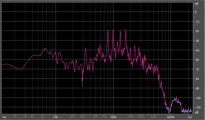

    Le goût de l'Audition:
    johnmeyer
    lordsmurf
    Last edited by JVRaines; 22nd Mar 2015 at 20:56. Reason: Botched it the first time.
  21. P.S. I just A/B/C'd the original, my restoration, and yours. Listen to the last few seconds of your restored audio: the speech is almost unintelligible. I'm not trying to pick a fight, but instead just want to point out that your stronger noise reduction does do damage to the audio that results in it being more difficult to understand. This gets to the points in my previous post.
    The famous architect, Mies van der Rohe, was fond of saying "less is more." It is true in architecture, but even more true when doing restoration work.
    [edit]I too was going to post the spectrum analyzer shots, but wasn't sure anyone could interpret them. You have to specify what portion of the clip you feed into the spectrum analyzer.[end edit]
    Last edited by johnmeyer; 22nd Mar 2015 at 20:51. Reason: Added response to simultaneous post

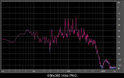

    Kinda messed it up; sorry, I'm rusty on the image upload tools. Anyway, I used the "after" portion of john's file and the entire smurf file.
    What I see and hear: john's file slopes from 6 to 15 KHz then abruptly cuts off. smurf's file dives down from 6 to 9 Khz, then jumps back up to 15 KHz and gently arcs down. So smurf's file has a high frequency emphasis that john's is lacking, but dumps high vocal frequencies, which makes the women's speech at the end of the clip unintelligible.
  23. Originally Posted by JVRaines View Post
    Good catch. My restoration tool lets me specify a curve that can force the algorithm to be more aggressive at some frequencies than others. I did tell it to be pretty aggressive at frequecies > 5 KHz. Perhaps I should have been less aggressive at those higher frequencies.
    I really welcome the feedback, because my goal is always to satisfy the client, and everyone has different perceptions and tastes. Thanks, JVRaines, for taking the time to give me your analysis.
