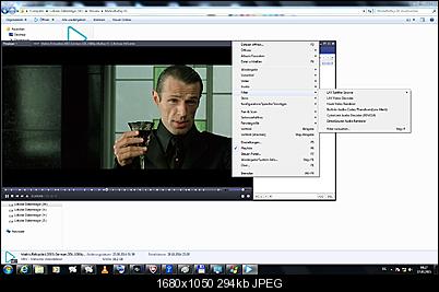

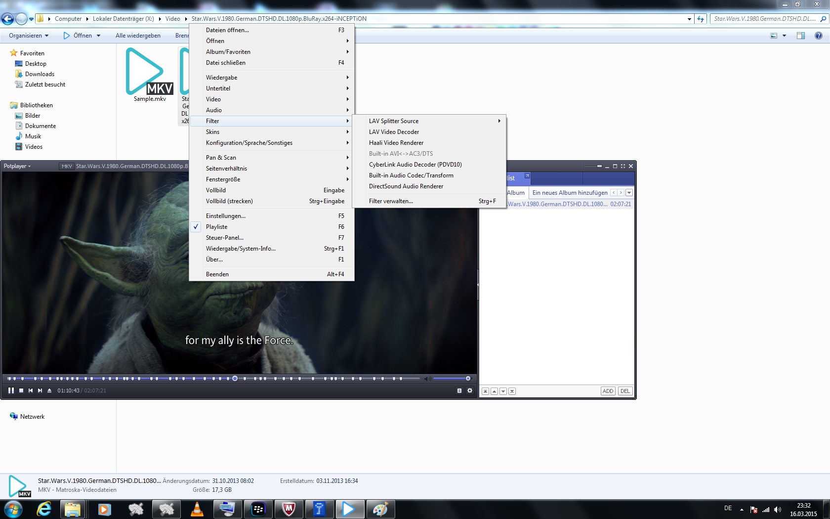

    The following Screenshot shows the filters used for a file with DTS and good sound levels:

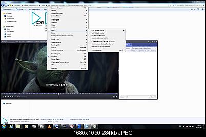

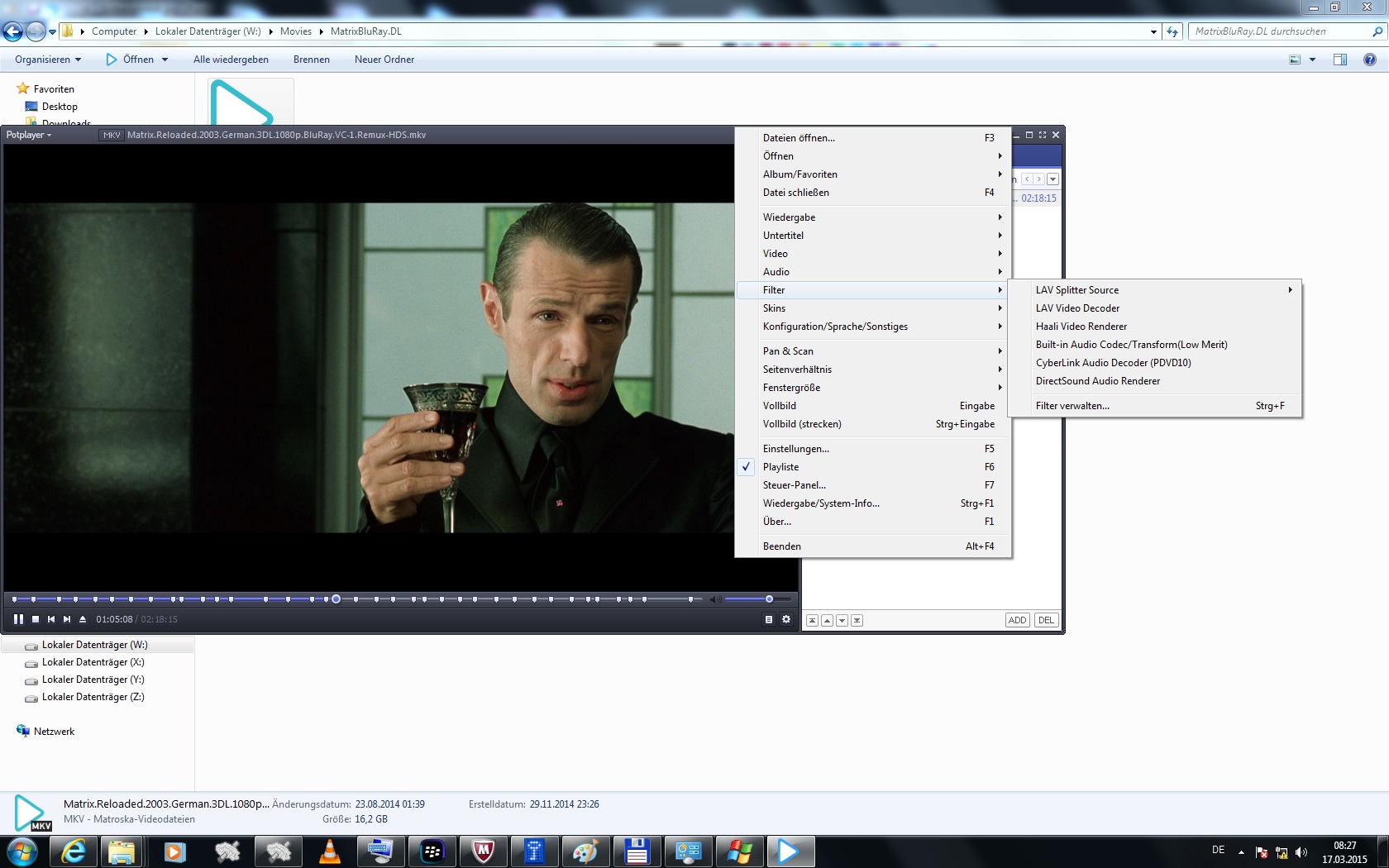

    The following Screenshot shows the filters used for a file with AC3 and very low sound volume:
    I assume that the Filter used just before the Cyberlink Codec makes the difference.
    The "Built-In Audio Codec/Transform(low merit)" appears to cause the low volume levels with Ac3 sound.

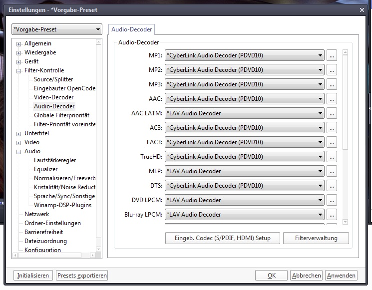

  5. How does your filter control-> audio decoders look like?
    @Allisone:
    The options you describe allow me to manually increase the sound, but that means that I have to adjust the volume differently for DTS and for Ac3. Furthermore if I use the option to amplify the volume, then the sound is kinda "metallic".
