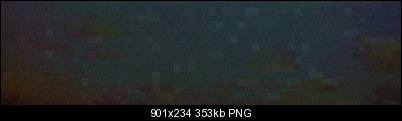

  1. Right at the top center, no matter my settings or bitrate, whenever I try to encode to mp4 using x264, this scene blocks up.
    Is there any way to prevent these blocks? Size is not an issue, but I do need to convert it as it is VC-1 and the player requires H.264.
    The attachment is cut from the original Blu-Ray unconverted.
    Thank you

    You mean this rendition of "Blocky Night" right?
    Those are definitely compression artifacts as the nearby i-frames are as clean as a whistle.

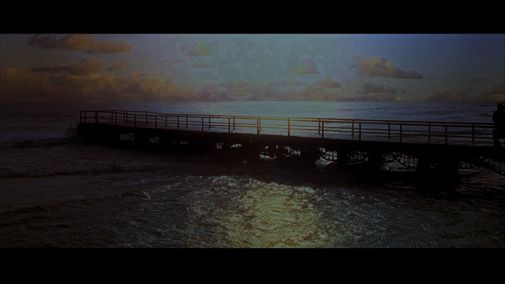

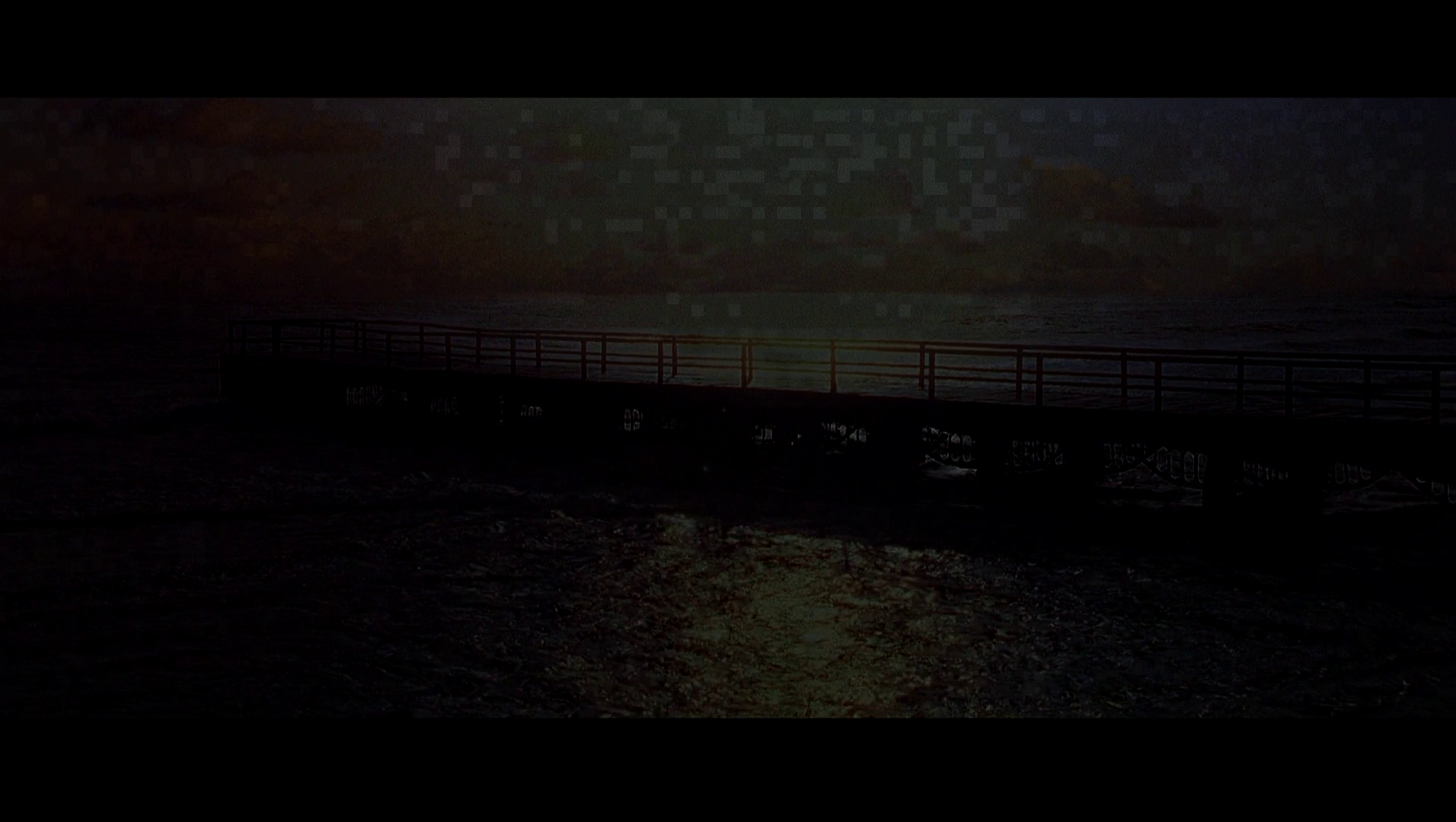

  7. If you decode with errors, the the errors will propogate into any encode. Bad decode => bad encode (regardless of what ENcoder you use)
    Any ffmpeg derivative will show those errors. So handbrake etc... ffms2 , lsmash for avisynth. One way to decode it correctly is to use windows' own DMO decoder. eg. through directshow

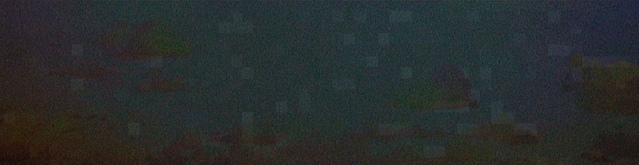

    Currently, the video plays without blocks, but the issue is encoding. While I would expect -blocks in, blocks out,- the tough part here is understanding why the video is decoding blockless in everything for playback while during encoding it is giving issues.
    I will play around with Avisynth but I have a bunch of VC-1 encodes I need to do. Looking for an easy fix but it looks like it may not be there.
    The attached photo is after Handbrake, will try MeGui with directshowsource and write back.
