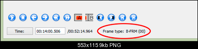

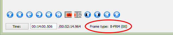

    A picture paints a thousand words:

    Thanks i loaded file now it shows frame type I-FRM(00)
    now what to do?
  12. Cut on the I frames.

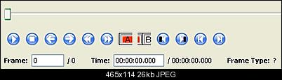

    Are you serious? You can't find something that looks like >> on your screen?
