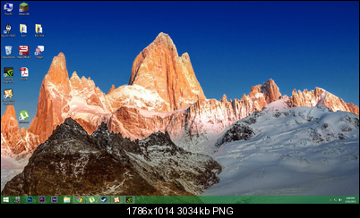

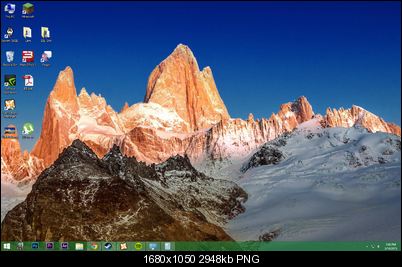

    I don't know if this would help, but if you can look at the files in fullscreen, you can see one is blurrier than the other.
ID:	30735Click image for larger version
