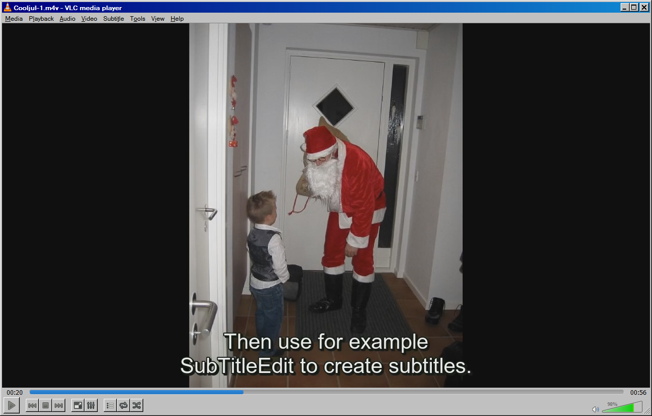

  9. I can hardly see what you can do wrong. Use the Import SRT button. Tick the Burn-in checkbox. Start.
Name:	Screenshot - 14-03-2015 , 23_45_46.png

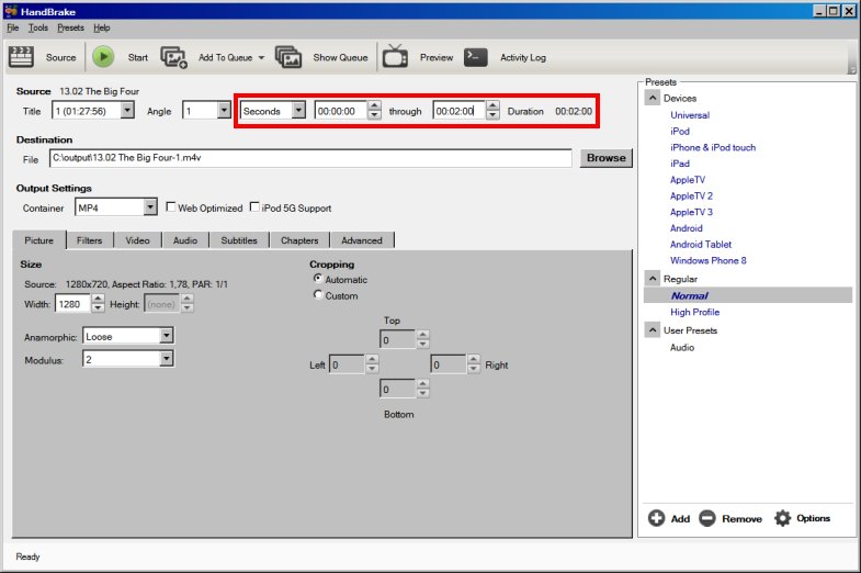

  11. Previews? If you want a "preview" encode a couple of minutes.
