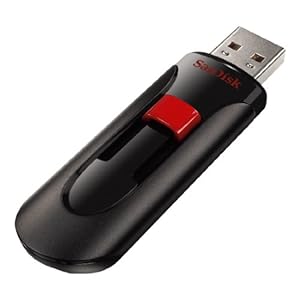

    Inflation adjusted TVs have never been this cheap, ever!
    You can buy a 32 inch 720p TV for under $200, for $100 more you have full HD.
    And yes they have USB input!
    You can buy a 128GB USB memory stick for under $50 and on it you can store over 50 DVD equivalent quality videos!
    That's right, you can put 50 DVD equivalent quality videos on this stick, and on Amazon I saw the price all down to $40!
    No, I seriously doubt the reason is money.

  9. I've never created a Bluray video disc in my life. The last time a created a compliant DVD video disc was quite a while ago. I use standalone files such as MKV. Still, I don't recall ever needing to post a picture of an ultra widescreen monitor in a thread where someone has asked about converting video to DVD format. I've never needed to post a silly pic related to DVD burning. If I had to post a pic of a USB thumb drive to try to validate my opinion I'd probably have to admit to myself I'm just wasting bandwidth.
    Suggesting an alternative after asking the OP why he's wanting to convert to a particular format might contribute something constructive, depending on the answer, but can anyone remember when newpball last contributed something constructive to a thread?
