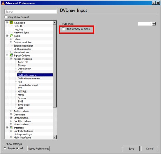

  5. In VLC did you untick "start directly in menu" (Default)
