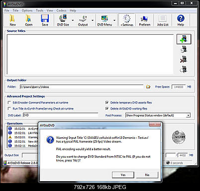

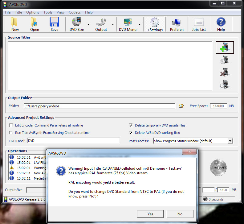

    Well this is interesting. I opened up AVStoDVD and loaded the clip that I posted yesterday. This was the warning I got. So I have to assume that the software is going to change the frame rate for me.Click image for larger version
  21. Originally Posted by Coffindan View Post
    I wouldn't assume that at all, unless by 'change the framerate' you mean so that it outputs 29.97fps. You've already said you understood nothing in jagabo's post, so don't make assumptions.
    If you want it to play on your NTSC DVD player, answer 'No' to the question. The statement about PAL encoding yielding a better result isn't even correct.

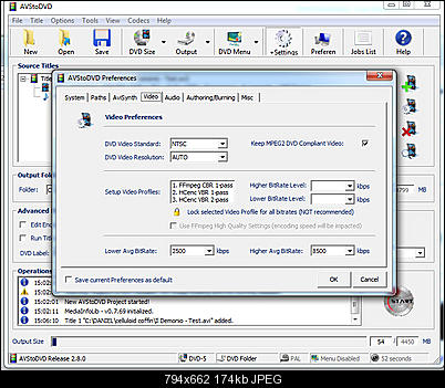

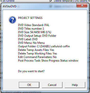

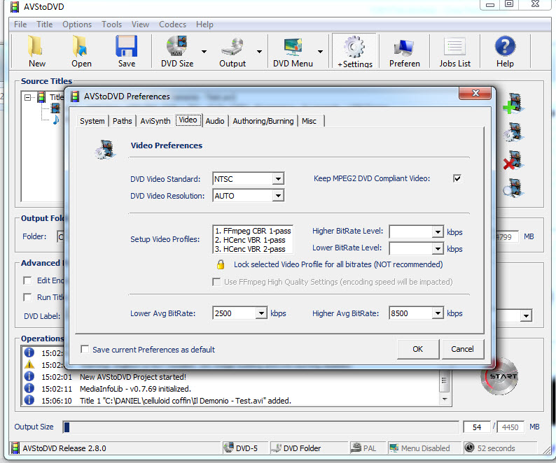

    Ok this is confusing. If I click the start button I get the following message:
    When I go to preferences it says the video preference is NTSC?
