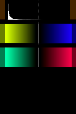

    I see plenty of it, and other problems. The dark details are badly crushed. In normal speak, crushed means destroyed. What's left of former detail is just noise -- macroblocks, mottling, smudged details, grime, lots of banding. Crushed darks during processing are made worse by the absurdly low bitrate used, which also gives you edge twitter, motion shimmer, object shift during motion, and lots of other horrible stuff.
    The YUV histogram below shows that darks are cut off below a point to the left of the white spike in the image -- there is no detail to the left of that spike.

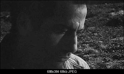

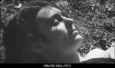

    How this translates into dark-level noise and banding is shown in the images below, frames 621 and 781. If you can't see that during normal work, I brightened everything below RGB 64 to make it more visible here:
Name:	frame 621 - avi.jpg
Name:	frame 781 - avi.jpg
    Consider it pretty well impossible to clean this garbage without destroying something. You can't restore detail that doesn't exist. You'll need Avisynth for this, and the effort probably won't get you much.

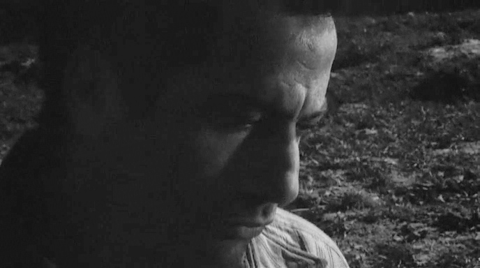

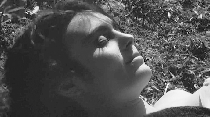

    A rip wouldn't cause those problems. A rip is a 1:1 copy or decryption, not a recording, not a capture, not a re-encode. If that rip was really a 1:1 copy -- which is what a rip is -- then that copy would have whatever problems were on the original DVD.
    Avisynth didn't quite mush it up. It smoothed the disturbances, or hopefully the worst of it. If you smooth noise and remove some of it, and if most of the "detail" is noise to begin with, you see what's left. The histogram tells me that if those black levels weren't smashed on the original, then they were screwed up during whatever processing followed.
    The script I used, below. Others will have different ideas. Encoded with TMPGenc Mastering Works.
    SmoothLevels(16, 1.0, 255, 16, 255, chroma=200,limiter=0,tvrange=true,dither=100)
    dfttest(sigma=3)
    Dither_convert_8_to_16()
    GradFun3(lsb_in=true,lsb=true)
    DitherPost()
    LimitedSharpenFaster(strength=50)
    addgrainC(1.5,1.5)
    grayscale()

    I definitely retract what I said about not seeing it in the original. I didn't have it full screen on the pc at the time and really noticed the problem once I burned the dvdr and was watching it on the tv. I get what you are saying though by looking at the stills, I can see that the end result using Avisynth might end up just mushing things up. I downloaded avisynth though and once I figure out how that works, I will experiment. I guess the original rip was done with a low bitrate which caused all this to begin with?
    dfttest(sigma=3)
    DitherPost()
    addgrainC(1.5,1.5)
    grayscale()
    Wow! Taking a look at the clip and I can really tell a difference! I didn't look at it last night because the download was going to take awhile. Here at work our speed is really fast so it only took a few seconds.
