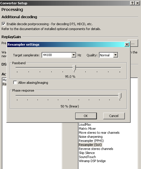

  23. There's a SOX re-sampling DSP you can use with foobar2000's converter (foobar2000 comes with one called Resampler PPHS but apparently SOX is better). No reason why you couldn't convert the audio to a wave file while resampling it (you can add DSPs to the conversion path) and then edit it with whatever audio editer you prefer. Or edit it first, then convert/re-sample it.
    You'd probably just want the "normal" version. http://www.hydrogenaud.io/forums/index.php?showtopic=67373
    You can install DSPs via the File/Preferences menu under the "Components" section.
