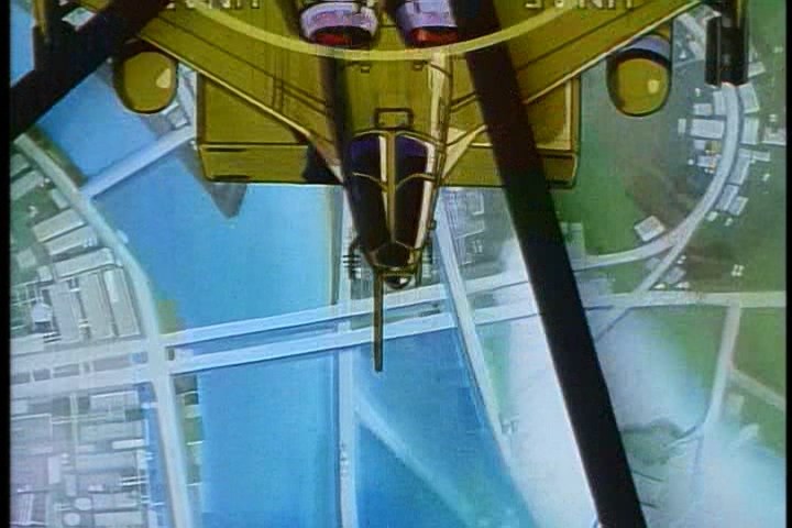

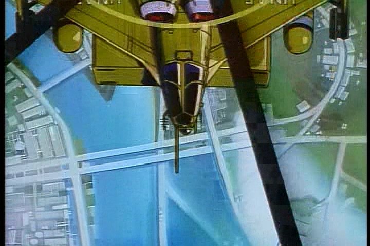

    I'm using Xvid's Target Quantizer, set at 1.0. Attached are two screenshots of my new AVIs using M2V videos as source--one showing the result of using only one video source, and the other using two video sources. From what I can tell, neither QTGMC nor Srestore are working in the second example.
Name:	M2V - One Source.jpg
Name:	M2V - Two Sources.jpg
  27. Originally Posted by lomaidala View Post
    Okay, so for each DVD, I load the VOB into DGIndex, save and demux, then load the M2V into DGIndex and save.
    Ordinarily, no. You load the VOB(s) into DGIndex and File->Save Project File. No demuxing. You then use the D2V you made in your AviSynth script. Together with the DGDecode.dll and MPEG2Source, you'll open the DVD in VDub or wherever.
    Why on earth would you do that? It makes a bloated file for not much gain in quality over using quant 2.
    Your second picture is a mess, all right, but I don't know enough to be able to say what caused it. You did make the D2V using 'Honor Pulldown Flags' in DGIndex, right?
