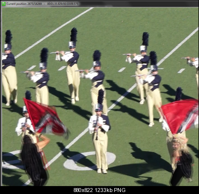

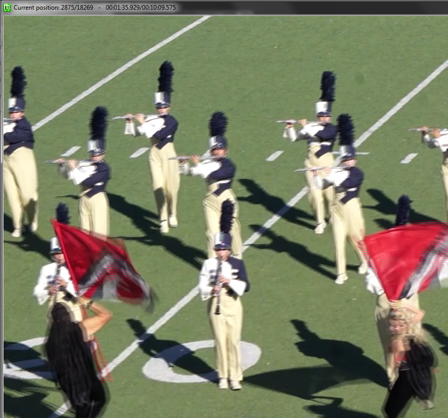

    Here is a small screen shot with 1:1 pixel mapping of what I think looks like obvious combing due to interlaced content. Note that the red flags are moving really fast in the image.
    INTERLACED EXAMPLE

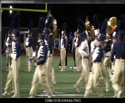

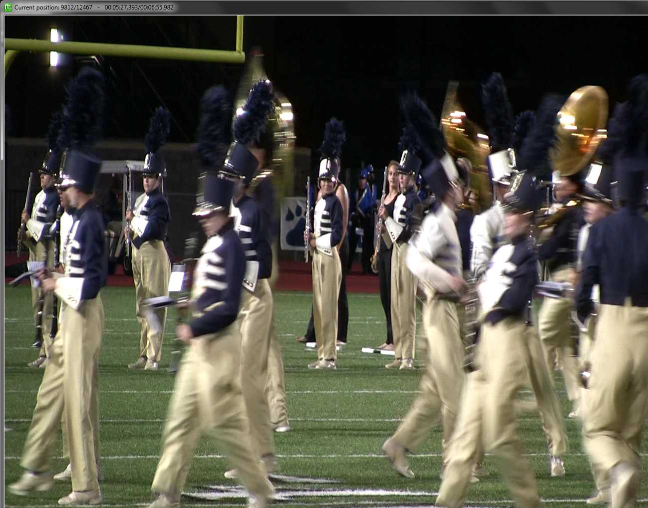

    Here is a screenshot from the MeGUI approach of my HDV progressive content that is blurred but no combing. It also had the aa bb cc dd ee cadence in DGIndex/Virtualdub. I should also add that the image looks stretched because the pixels are not square.
    PROGRESSIVE EXAMPLE
