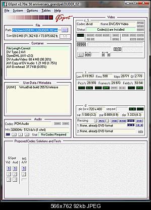

    I have uploaded a family video on youtube that I'd like someone to please view and let
    me know if the capture is as good as it will get...or if some tweaking to my hardware
    /software can produce better results...
    http://youtu.be/bGJFUb7QmbY

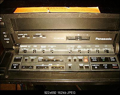

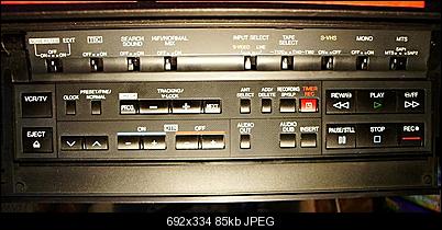

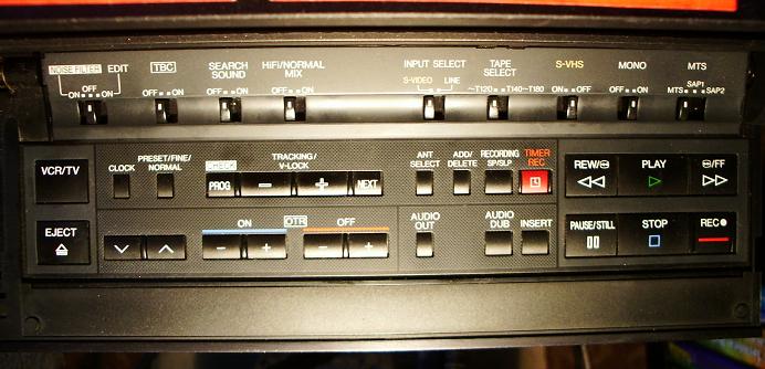

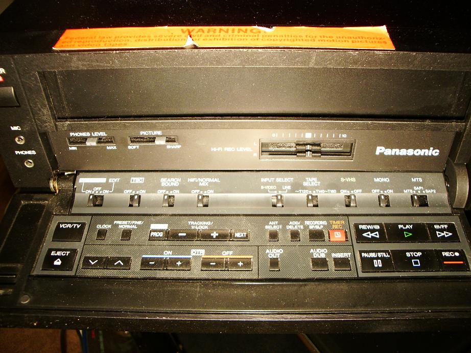

    Panasonic AG-1970, with TBC on, Sharpness slider on Panasonic set to about 75%...here's a pic of settings...

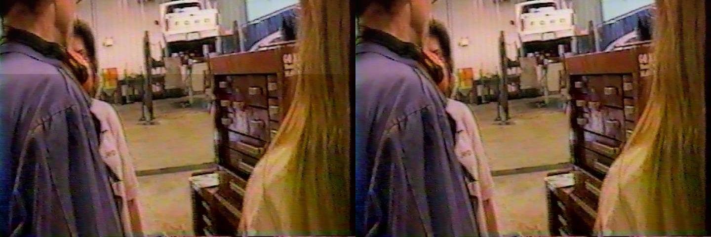

    Issues about the video

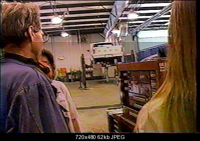

    I noticed that the video sometimes has a Green slash/blip that shows up during the capture but
    does not show up when you view the video directly from VCR to TV via Coax cable.
    Video was take by hand held camera...but can any of the Shakiness be take out/reduced in the final capture

  2. Member Skiller's Avatar
    Oct 2013
    Germany
    Looking at your YouTube video it seems the green flash shows up exactly at the scene change, where at the time of recording the camera operator pushed stop or pause causing an interruption in the signal on the tape. So does this green flash only show up at such scene changes?
    Deshaker

    Personally I would prefer to have the AG-1970 in Edit mode. Set the slider on the very left to "EDIT ON".
  3. Thanks about the Deshaker plugin for Virtualdub, I just ran it through a few settings and it just makes everything steady...almost like it the video was on a tripod and not in somebodies hands....almost.
    Found a useful youtube video that got me started with understanding Deshaker...
    www.youtube.com/watch?v=nIo_AuYRVj0
    ...there are guide instructions for Deshaker on the web...
    http://www.guthspot.se/video/deshaker.htm
    ...but the video just made things more clear for me to follow/understand.

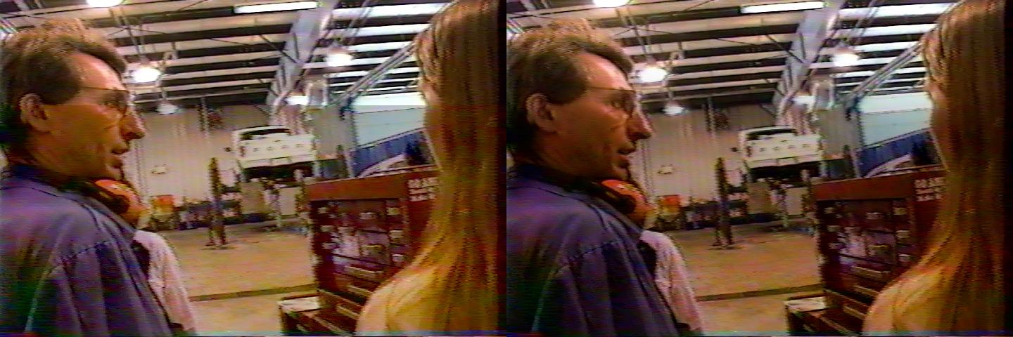

  4. Banned
    Oct 2014
    Northern California
    Top VCR
    TBC
    Good capture
    Encoded lossless: ?
    Properly deinterlaced:
    Uploaded at full resolution:
    Average and Max bitrates used: ?

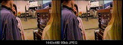

    Why is the video not frame doubled during the deinterlacing process?
    You just threw away 50% of your source.
    If you want to image stabilize I would recommend you upscale the video first as image stabilization calculations will result in sub pixel offsets (especially for rotations).

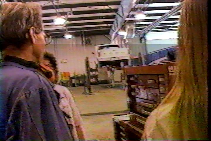

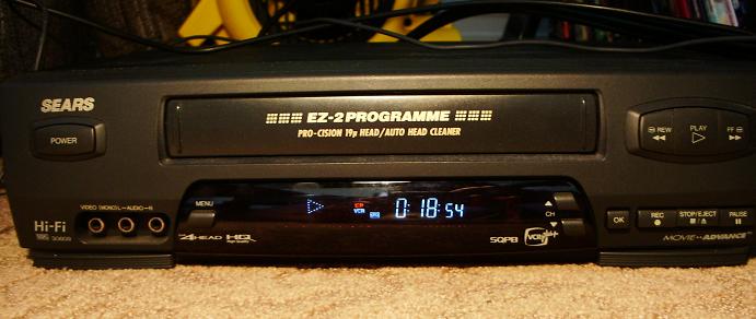

  5. wow...can someone explain this.

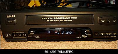

    just had an amazing capture...not from my Panasonic AG-1970...but an old SEARS vcr
    here's both setups
    Panasonic AG-1970
    Panasonic AG-1970-->s-video cable (video)-->RCA, red+white cable (audio)-->Canopus 110-->Firewire-->computer/Windv
    SEARS VCR ez-2programme, HI-FI vhs 30609, SQPB, pro-cision 19u head/auto head cleaner, 4 head HQ, VCR Plus+
    Sears vcr-->RCA cables (audio+video)-->Canopus 110-->Firewire-->Computer/WinDV
    RESULTS
    panasonic AG-1970
    final video had tracking issues all over top and bottom of video...
    if TBC was on there was a verticall skipping of the video
    sound was like somone screaming into an electronic device, then playing it back...it's all
    scratchy and hard to hear
    SEARS vcr
    amazing, it was as close to watching the vhs tape being played from vcr through coax and into
    the tv as I have seen, sofar, from a capture
    Video was clear, NO tracking lines, NO vertical skipping issues (well maybe one or two)
    sound was clear, super crazy clear compared to the Panasonic ag-1970...and both used the
    red and white rca cables??? what's going on there???
    VHS tape = TKD, T120 EHG, AGBJ802, Extra High Grade, Super Avilyn Technology Plus
    so my question(s) is...Why would this Sears vcr be better for my capture setup than the
    Panasonic AG-1970??? Is it just it's auto picture/correct feature???
    So far I have no sound/sync issues....can I expect voices to be out of sync in the future if
    I keep using the old SEARS vcr...???
    Is TBC just alot of hype???

  6. Member PuzZLeR's Avatar
    Oct 2006
    Toronto Canada
    I was watching this thread and wondering why is it that you liked the output from the AG-1970 so much. I have one and it's an absolutely horrible machine - not horrible, let me re-iterate - HORRIBLE.
    I have two "ordinary" VCRs, a Panasonic 4520 and a Panasonic 4521, as well as a third one, a Memorex 4046A when I feel like it, and these blow away these IMO over-rated so-called "professional" and "high end" decks, like the 1970, and including my two Panasonc AG-1980s that are either dead or collecting dust, and the JVC SR-V101US which blurs and over-processes most tapes, and the Mitsubishi I had and no longer have...
    These "high end" machines use a technology, processing and D/N/R that is now more than 10-20 years old and suited for the analog age, and have edit features that are useless today with modern computers. As well, the "TBC"s on these machines are either 99% useless or do (much) more harm than good. They create more jitter or output wrong field order, and make a mess of the video. Yes, these internal onboard TBCs ARE alot of hype IMO.
    That is, if these machines are not overly aged and defective and virtually un-repairable as of this post. That's another horror story worse still.
    So, IMO, don't be surprised that your Sears machine is doing better. I see it's a 4-head, HiFi deck, very similar to my "ordinary" VCRs. As well, it's a black and simple unit (not silver or a DvD-combo unit).
    I say you're doing well. If you use a stand-alone DVR pass-through TBC, and a bit of post-processing on a PC, you will do even better still.
    (I prefer to use lossless video for captures myself.)
    I hate VHS. I always did.

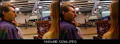

  15. O.K...little update on this crazy adventure call "video capture"
    Maybe I was a little quick to judge my Panasonic AG-1970
    I just had a video capture, with SEARS VCR, that was not as good as I would like it to be...there were some tracking lines/blurs creeping up from the bottom of the video...they would maybe cover 1/5th the screen for a few seconds then fade away down and out of the screen when the SEARS VCR would correct them...but it was an off and on thing...
    So I got curious and put the VHS tape into the Panasonic AG-1970 just to see what would happen...GREAT capture...audio great and video has not tracking issues...it's like both VCR's will give me great captures...but not with every VHS tape.
    Captures that came out great...
    Panasonic AG-1970 (settings)
Name:	Panasonic settings_yt_resizejpg.jpg
    VHS Tape = Kodak, T-120 HG (no cover box = no other data to give...purchases in mid 1990's)
    Also to note the Panasonic AG-1970 detected the tapes recording speed (if speed is what I mean)
    Kodak = SLP (extended play was marked on tape and there is about 6 hours-ish of tape to view)
    TDK = SP (and only about 2 hours of tape to view)

    Very easy problem to fix if you like the Sears quality better. I do this for the odd tape that doesn't track as well on my ordinary machines when I really like the output.
    Capture the tape as normal with the Sears, with the tracking fuzz at the bottom. (Let's call it "Upper.avi".)
    Capture the tape again with the Sears, this time set the tracking to clear the bottom fifth, even though the top will be all distorted. (Call it "Lower.avi"). Don't change any settings on color or sharpness with anything.
    Then use a script to keep the top of one, and the bottom of the other.
    Upper=AviSource("Upper.avi")
    Lower=AviSource("Lower.avi")
    StackVertical(Upper.Crop(0,0,0,-96),Lower.crop(0,384,0,0))
    This will take the top 80% of the normal capture - the good pixels, and replace the botton fifth with the pixels from your other capture where you adjusted the tracking for the bottom.
    This assumes you are capturing in NTSC at 480. If you are in PAL, and capturing to 576, then replace 96 with 112, and 384 with 464. Notice I used muliples of 16 when cropping horizontal - this is to make sure you don't wreck the interlacing.
    Use the Trim() command to make sure the streams start in the same frame, and make sure there are no dropped frames. (I can get into detail on this correction too if you like.)

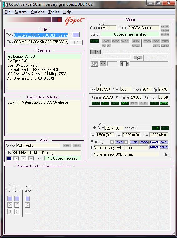

  21. So, attempting to use avisynth I've come to some issues...
    PROGRAMS BEING USED
    AviSynth 2.6 = installed
    VirtualDub 64bit (Veedub64.exe)
    Text Document (file extension changed to .avs)
    is avisynth a case sensitive program (captial letters and lower case letters???)
    THIS IS MY TEXT DOCUMENT
    AviSource("C:\Users\USER\Videos\Captures\50 Anniversary\50 anniversary_grandpaLOUDER_02.avi")
    In virtualdub I go...File-->Open video file-->grandpa.avs...then I get this error message...AVI Import Filter error: (Unkown) (80040154)
    I've also tried...File-->Run script...and I get another error message...but I don't even get to see my .avs files unless I change a setting from detecting "all scripts" to "all files"
    I've even changed the text file to...
    DirectShowSource("C:\Users\USER\Videos\Captures\50 Anniversary\50 anniversary_grandpaLOUDER_02.avi")
    exact same error message if I try to open this grandp.avs file in virtualdub
    just outta the gate and I've already done a face plant.
    This is a Gspot capture of the video file being used
    UPDATE sound issues
    My Panasonic AG-1970 was giving me distored sound with one of my VHS tapes...I was told to switch a setting on my Panasonic AG-1970 from "HiFi/normal mix = ON" to "HiFi/normal mix = OFF"...so I did that (off)...recaptures the VHS tape...but the audio was still distored...hitting the on/off switch did not seem to make that particular VHS tape capture any better.
    ...and that's ok since my SEARS vcr did a great job of capturing the video and audio...just ran that little test to see if the results would change with that Panasonic AG-1970...they didn't.

  26. I've managed to get some avisynth scripts working
    The StackVertical is nice and I've used the code you've given me to merge two different halves of identical captures...by moving the tracking lines around to get one capture with a clear bottom and a second capture with a clear top...
    However...the results were not nearly what I have hoped for...
    Moving the tracking lines around on the VCR also causes each video to have different a brightness levels.
    The bottom video/splice is much darker than the top video.
    Even when watching the video I have aligned them as best as I can using the "Trim()" command to get one of the videos to start at the same time as the other one...but it still does not seem to line up perfect...and adjusting the frame in the trim brackets up or down just one frame causes the video to noticeably be out of sync
    The above image is as best as I can get it...if you look at the mans bottom earlobe things don't seem to match.
    Viewing both video clips in MediaInfo says both clips are running at 29.970/fps...if it matters...both videos MediaInfo results are identical except for each videos overall Druation (7 seconds vs 5 seconds)
    This is my entire .avs file
    clip1 = DirectShowSource("C:\Users\USER\Videos\Captures\Du an Visit\Edit_allClean.avi") ("clip1.avi")
    clip2 = DirectShowSource("C:\Users\USER\Videos\Captures\Du an Visit\Edit_fuzzyTop.avi") ("clip2.avi")
    Stackvertical(clip1.Trim(50,0).crop(0,0,0,-330), clip2.Levels(0, 1.4, 255, 0, 255).crop(0,150,0,0))
    So...
    Is there a better way to get perfect video alignment?
    And, will tinkering with Level settings correct the brightness to match...ever, or just likely get it close enough?
    Are there different script/changes you/anyone could recommend for me.? Please and Thanks
    Last edited by bthomas; 20th Mar 2015 at 16:52. Reason: edited out a question that I just found out the answer to...how to quote people

  30. Thanks for your tips on blending with that gradient/alpha mask.
    The video below uses the exact gradient/alpha mask that you uploaded...and the results were great...the only thing off I notice is that the lower colors seem more red-ish, were the video splice occurs, and the top half seems lighter...You can see this if you look at the man's lower cheek on his face VS his upper head.
    Video = http://youtu.be/j321av6fCpc (no sound)
    ...you can see the splicing effect tearing at the end of the video...it's ok, one video was just a second or two longer...the overall blend/feathering of the to videos is still pretty nice.
    LEFT= stackvertical(), crop()...splicing of two videos
    RIGHT = Layers(), alpha mask...(Black and White gradient)
    Here is the script I used to put the video clips together
    clip1 = DirectShowSource("C:\Users\USER\Videos\Captures\Du an Visit\Edit_allClean.avi", audio=true, pixel_type="RGB32")("clip1.avi")
    clip2 = DirectShowSource("C:\Users\USER\Videos\Captures\Du an Visit\Edit_fuzzyTop.avi", audio=true, pixel_type="RGB32")("clip2.avi")
    channel_mask = imagesource("C:\Users\USER\Videos\Captures\Duan Visit\amask.png", pixel_type="RGB32")
    final_mask = clip2.mask(channel_mask)
    right_panel = Layer(clip1.Trim(50,0), final_mask)
    left_panel = Stackvertical(clip1.Trim(50,0).crop(0,0,0,-330), clip2.Levels(0, 1.4, 255, 0, 255).crop(0,150,0,0))
    stackhorizontal(left_panel, right_panel)
    Alot of the,above, script in not necessary...the Horizontalstack...script was just to show the two videos side by side
    Simplified script below
    The Trim(50,0) command was only there to shorten one of the videos so that it would sync up with the other video, some people may not need to use it.
    Also I had to put in pixel_type="RGB32" for my video sources and image sources.
