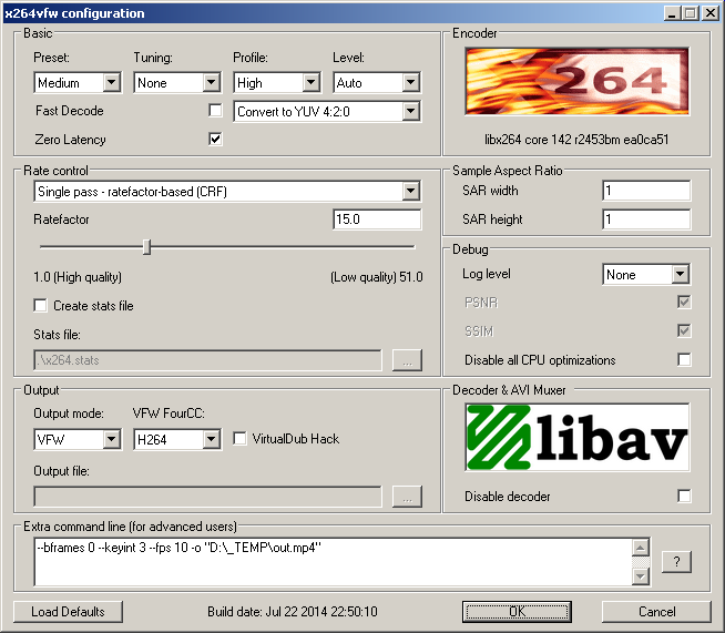

    You need to use custom commandline script to save as mp4. Here is what I use for CamStudio / x264_vfw settings.
    *Note I'm capturing @ 10 fps, You'll need to change the command to your framerate...
    Feb 2006
    Thanks for that racer-x. I presume I can leave out the bframes and keyint options?
  4. Member racer-x's Avatar
    Mar 2003
    3rd Rock from the Sun
    Yes, the main thing you need to enter is the path to the output mp4.
    Example:
    -o "C:\cap\out.mp4"
    Feb 2006
