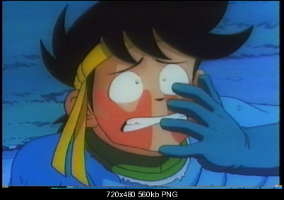

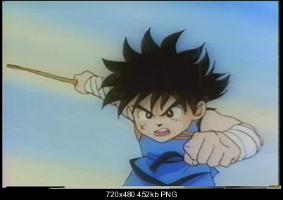

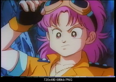

  3. here are some PNGs from the raw capture:
ID:	30625Click image for larger version
ID:	30626Click image for larger version

    I've had a look at the sample now. It's blended all to hell and back. I don't know how to treat it. You didn't have the noise reduction on, did you, when you captured?

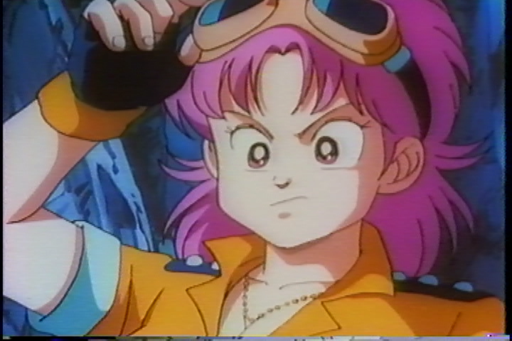

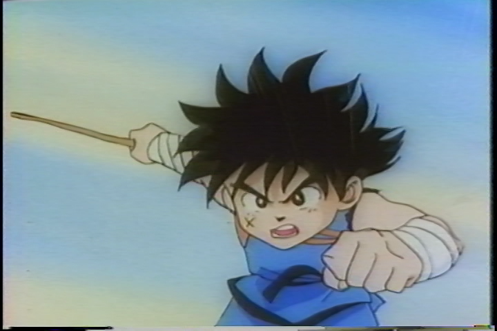

  14. is the sharp function on AviSynth recommended over the unsharp mask in virtualdub filters?
  15. There's too much blending. I'd skip the IVTC and deblending and smart bob to 59.94 fields per second instead.
  16. can you give me a script example for setting up the smart bob in avisynth or virtualdub?
  17. is this good enough, what else am I missing, I didn't understand how to smart bob the video
    Load_Stdcall_plugin("C:\Program Files (x86)\AviSynth 2.5\plugins\yadif.dll")
    directshowsource("1.avi")
    Yadif(Mode=1)#or the better QTGMC
    Srestore(FRate=23.976)
    ConvertToRGB32()
    LoadVirtualDubPlugin("C:\Program Files (x86)\VirtualDub-1.10.4\plugins32\NeatVideo.vdf", "NeatVideo", 3)
    NeatVideo("C:\AVS\SampleProfile.dnp", "C:\AVS\SamplePreset.nfp", "1.0", "3", "1", "0")
    Unsharp(varY=1.5, varC=1.5, strength=0.7, border=4, integrate=false, Y=3, U=2, V=2, gfunc=-1, gfuncc=-1, pcr=0, pcrc=0, nthreads=1)
    Crop(4,0,-8,-8).BicubicResize(640,480)
  18. Originally Posted by user10495 View Post
    The first part of the script I provided bobs the video (doubles the framerate):
    I wouldn't use DirectShowSource if I were you, but the better AVISource for your DV AVI captures. Get the Cedocida Codec if you need it for DV AVI.
