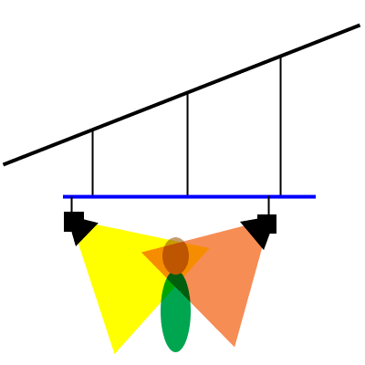

  13. Member Cornucopia's Avatar
    For angled roofs (especially ones that are high), the best thing is a drop-ceiling grid (usually made out of metal pipe). See the graphic:
    Mar 2015
    Thanks thats a fantastic image. My ceiling is not overly high, but I will mimic that format in mounting the lights.
    If I get time I will try and mount and even take some pics this evening. All depends on how the wife is feeling. Shes pregnant so That takes precedent.
    Been working on this project for about two years. I work full time, 6-7 days a week so its been a lot of late nights building and working on this in the evenings after the family goes to bed.
    Getting into the good stuff now.
    Again, appreciate all the info. I wouldnt have set my lights up like that. Thanks
  15. Member Cornucopia's Avatar
    It doesn't have to be set up that way, but if you go to TV/news studios, that's very often how it is set up. Just do a google search on "lighting grid" and you'll see what I'm talking about.
    Does this look familiar?...http://www.simplifiedbuilding.com/projects/lighting-grid-offset/
