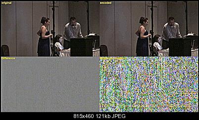

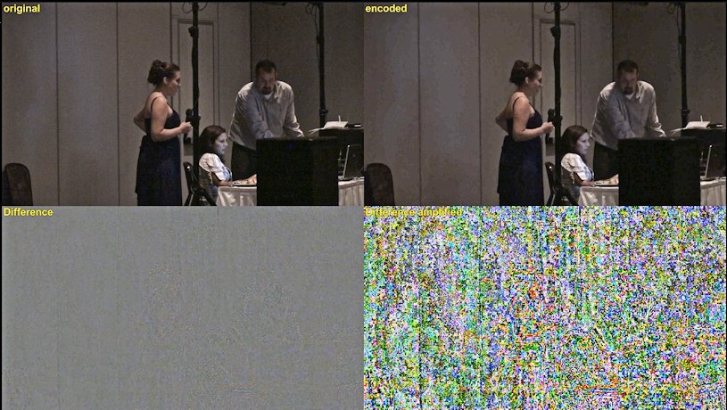

    A while back someone gave this AVISYNTH to check how much noise, blocking, etc. was introduced and I use it a lot as a quick 'enhanced' comparison, no matter what size the video is.
    v1=directshowsource("C:\Users\Bud\desktop\Wedding\ 00166.mts", audio=false).ConvertToYV12()
    v2=directshowsource("C:\Users\Bud\Desktop\Wedding\ 00166.avi", audio=false).ConvertToYV12()
    sub = v1.subtract(v2)
    substrong = sub.levels (122,1,132,0,255)
    return StackVertical (StackHorizontal (v1.subtitle ("original",size=60),v2.subtitle("encoded",size=60 )), StackHorizontal(sub.subtitle("Difference",size=60) ,substrong.subtitle("Difference amplified",size=60)))
    Gives a nice comparison:
