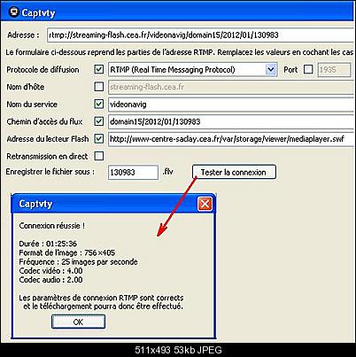

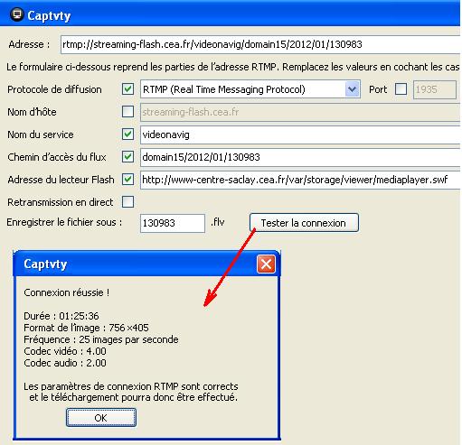

  6. Hi ,
    @ponens : thanks .
    Verifying the link !!!
    Regards .

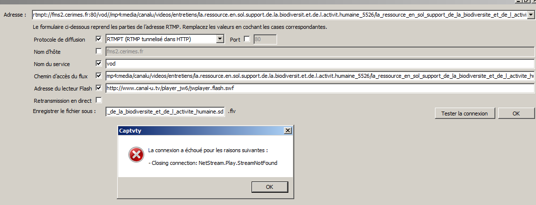

    I tried using CapTvTy as above, but it fails when trying to download the following video: "Closing connection: NetStream.Play.StreamNotFound".
    Here are the URLs I sniffed:
    rtmpt://fms2.cerimes.fr:80/vod//mp4:media/canalu/videos/entretiens/la.ressource.en.sol.support.de.la.biodiversit.et.d e.l.activit.humaine_5526/la_ressource_en_sol_support_de_la_biodiversite_et_ de_l_activite_humaine.sd.m
    http://www.canal-u.tv/player_jw6/jwplayer.flash.swf
    http://www.canal-u.tv/video/universite_rennes_2_crea_cim/xmlfile.1/la_ressource_en_sol...aine.5526.smil
    I attached a screenshot.
    I tried a few things for the URL Flow field, but none worked.
    Anybody knows what I could try?
    Thank you.

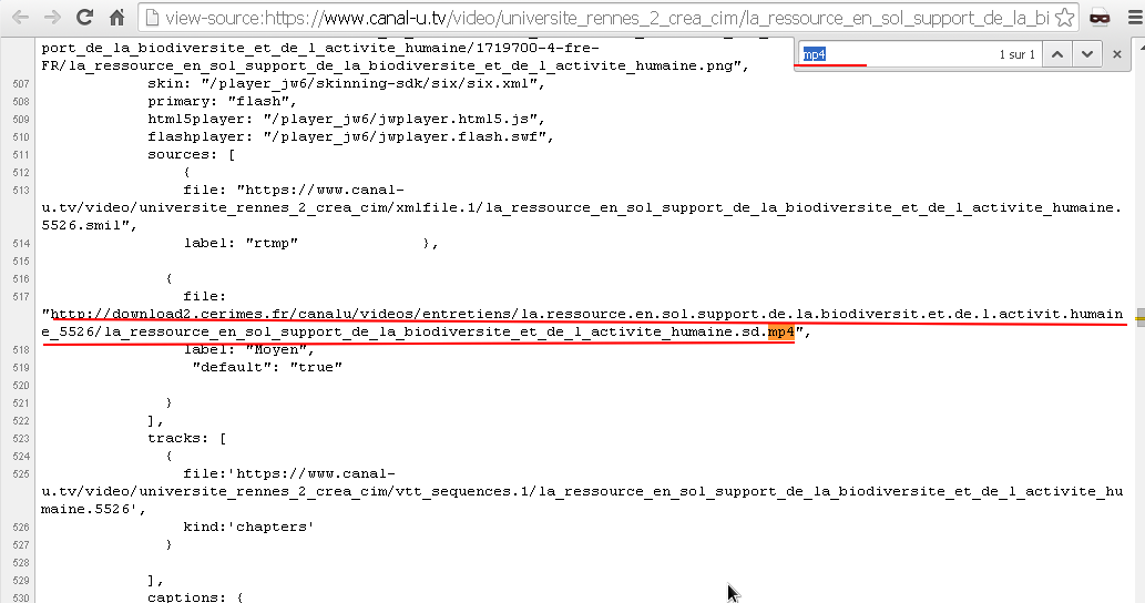

  14. but sorry sorry there is a much simpler way
    just disable flash plugin in firefox browser
    "pourquoi faire simple quand on peut faire compliqué"

    it was sufficient from the beginning, read source code

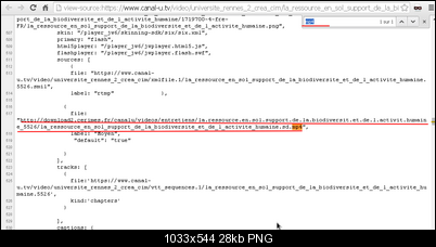

  18. just view page source and search for mp4
