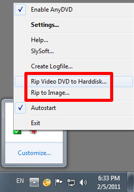

  7. A Member since June, 2004 Keyser's Avatar
    Feb 2013
    Westernmost point of Europe
    AnyDVD is also a ripping tool.

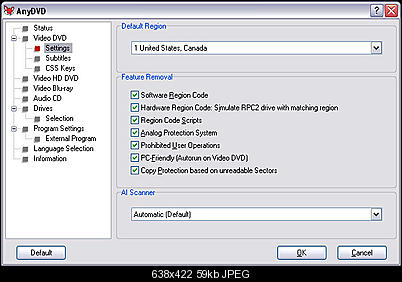

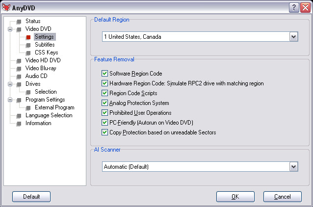

  9. A Member since June, 2004 Keyser's Avatar
    Feb 2013
    If the right options are enabled, yes.
