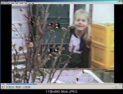

  24. I don't know about the other players you're using but VLC's de-interlacing option doesn't seem to stick when enabling it from the video menu (it kept disabling itself for me each time the video stopped playing). Enabling it via Tools/Preferences/Video and setting it to automatic works and Yadif (x2) de-interlacing does the job (frame doubling). Blend de-interlacing is fairly awful.
    Your sample also looks fine when played with MPC-HC and I remuxed it as a ts file with tsmuxer, stuck it on a USB stick and tried it with my Bluray player and it looked like it was being de-interlaced properly. I don't know why you're having so much trouble with it.
    Blurry due to movement, but VLC with Yadif (x2) de-interlacing.

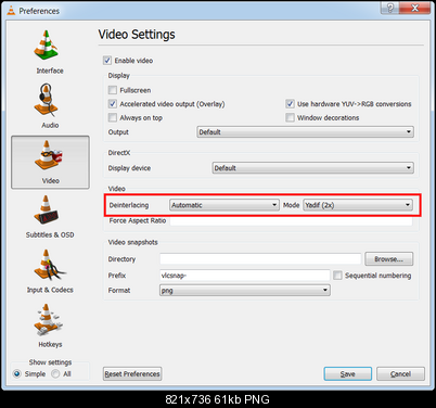

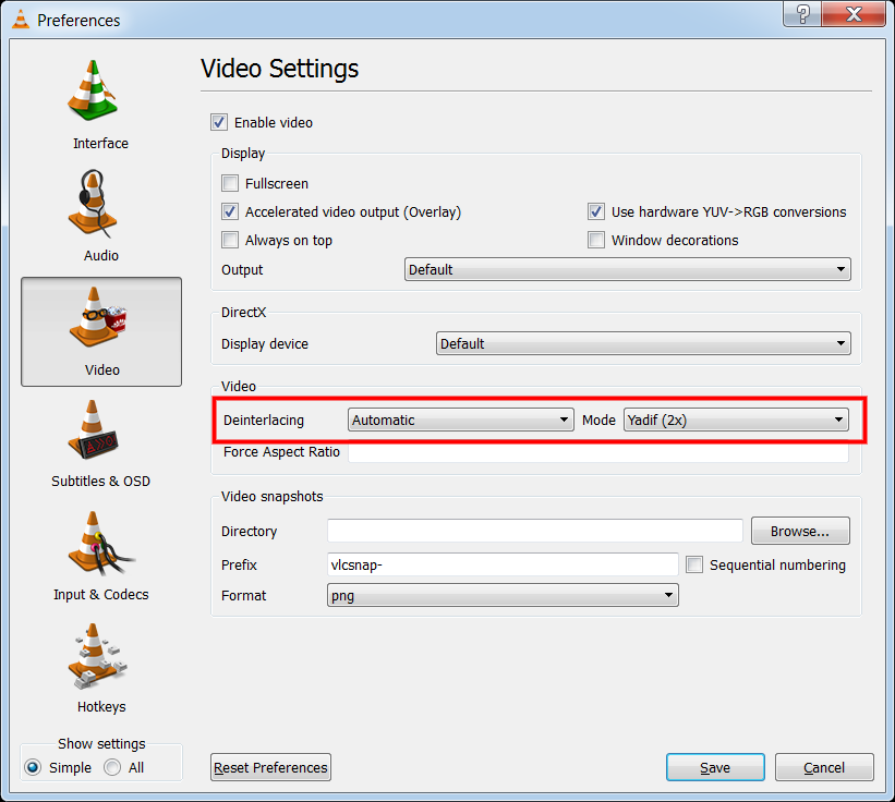

    Go to Tools/Preferences and select Video on the left side, activate "Enable Video"
    In the box named Video there is an option for "Deinterlacing", you can put it to Off, Automatic or On. Right of this option is the "Mode".
    Press Save and it should use the setting you selected by default.

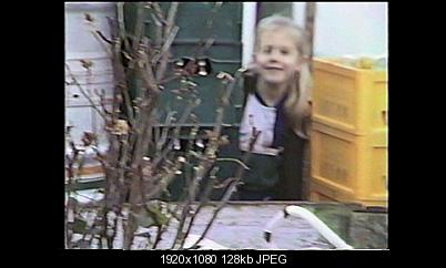

  26. Blurry due to movement again, but MPC-HC running fullscreen on a 1080p TV (playing/de-interlacing the sample from post #14):
    The problem might be in regard to how well the video is being de-interlaced, but there's nothing wrong with it a such.

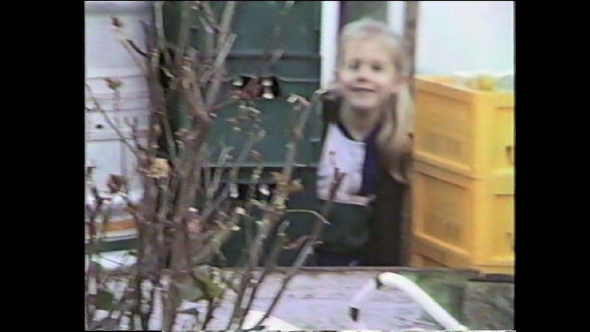

    De-interlaced with QTGMC, cropped and resized. Then again with Yadif de-interlacing. Both 50fps. Most encoder GUIs will have Yadif de-interlacing. QTGMC is a fair learning curve.

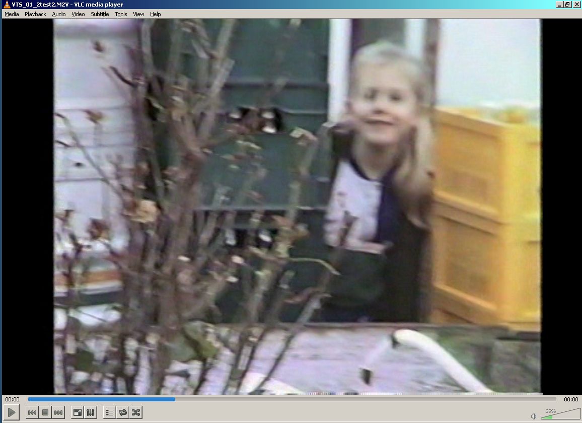

    VLC played your video fine on my computer, deinterlaced to 50 fields per second. No comb artifacts. Make sure you have deinterlacing enabled in VLC:
