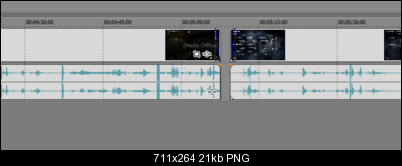

    When editing clips in Sony Vegas, if I leave a gap between clips (pic below) and I render the video in .wmv format (6Mbps HD 720-30p Video)
    it works like a charm
    But if I don't leave the gap or it's too small, the rendered video will be all black, no sound and too short (like 25sec video will be 10-15sec) and
    it renders too fast.
    No transitions or video fx has no effect (I mean they do work, but don't affect the issue)
    So if you guys could help me I would appreciate it, thanks!
