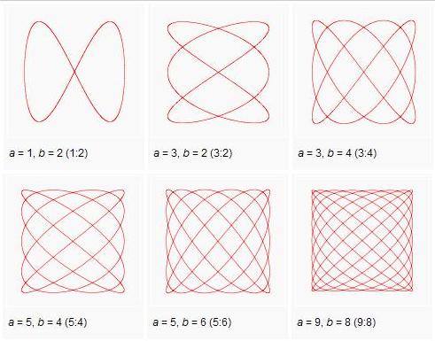

    1. The (black & white) analog TV signal can be thought of as a kind of Continuous Sine Wave. In 2 dimensions (H, V or height, width). This is what's known as a Lissajous signal. The voltage intensity of the ("now") instantaneous point of the wave corresponds with the luminance of that "pixel" (if mapped onto a digital grid).
    2. This Lissajous sine wave is NEVER exactly a horizontal line like we think it is/ought, it is a diagonal. ALL horizontal lines on a (old-school CRT) TV are actually slightly diagonal. Witness this succession of diagonals as they tend closer and closer to horizontal (only the LAST one is actually perfectly horizontal):

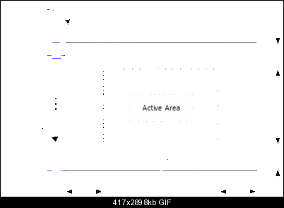

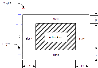

    3. Through the majority of the wave's oscillation, it is BLANK (aka BLACK). This is known as "blanking" (duh!). Only during it's "active picture" stage does an image show.

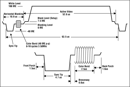

    5. Linearly over time, the signal looks more like this (this is 1 scanline's worth):
    6. Complication: The presence of the sync pulses tells the oscillator to temporarily speed up so as to not waste as much time during the "hidden"/blank ("flyback") portion as during the active picture portion (otherwise there would be even LESS active picture, percentage-wise). Notice in the pic above the small time portion allotted to the blanking (seen as the "front porch" and the "back porch").

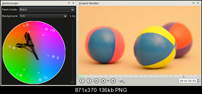

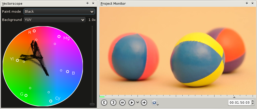

    7. Color is tacked on as a modulation (usu. phase or freq. mod) of that luminance, where the modulation "steers" the color a certain multi-vector distance away from perfect/plain Black-Grey-White. Also continuous.

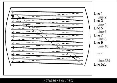

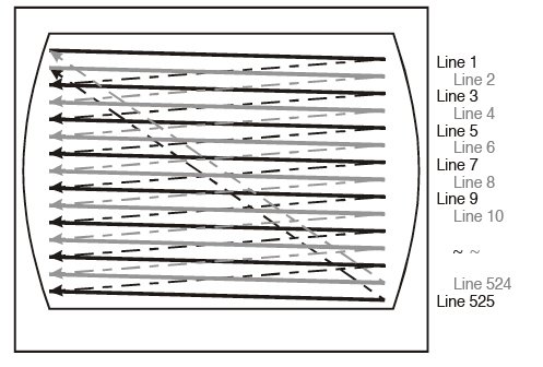

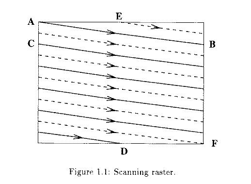

  10. The analog raster scanning would more accurately be pictured as:
    (Image taken from http://lea.hamradio.si/~s51kq/V-BAS.HTM)

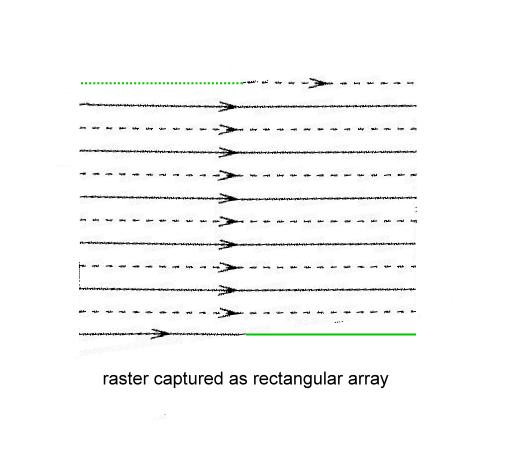

    As you can see, the active picture includes only half of the top and bottom scan lines. Hence the active picture is contained in 485 lines. Computers like working with rectangular arrays. So when those 485 scan lines are captured (and stored) the first and last scan lines become full scan lines giving a total of 486 lines:
    The green lines represent extra data that is captured (which is black) or filled in with black.
