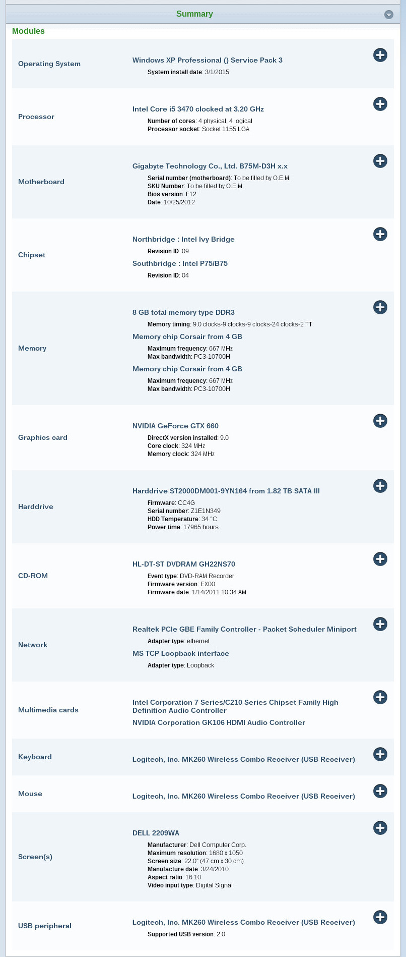

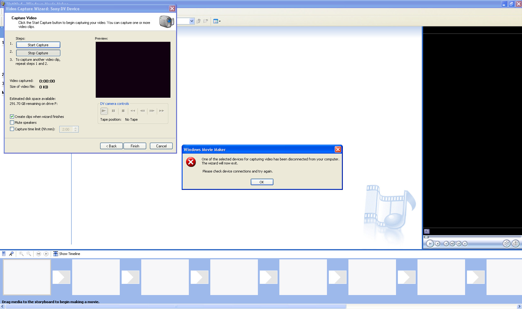

  6. Thank you all for replying.
    I've attached the following images :
    1) My machine & firewire info.
    2) The error message i've just received.
    I've restarted my PC, connected the Sony using the firewire, followed
    the media player steps and once i clicked on play (to preview my video) the
    error message appeared.
    Comments:
    1) On my new machine I've installed Win.7.
    2) 3 days ago i've downgraded it to a clean WinXp SP3 to try and
    overcome the problem.
    3) About a week after I bought my new PC, I bought a new firewire that
    according to the salesman should be compatible to 64bit.
    I'll be happy to hear any ideas...
    Hardware...
    or maybe a menu configuration inside the cam that I forgot about ?

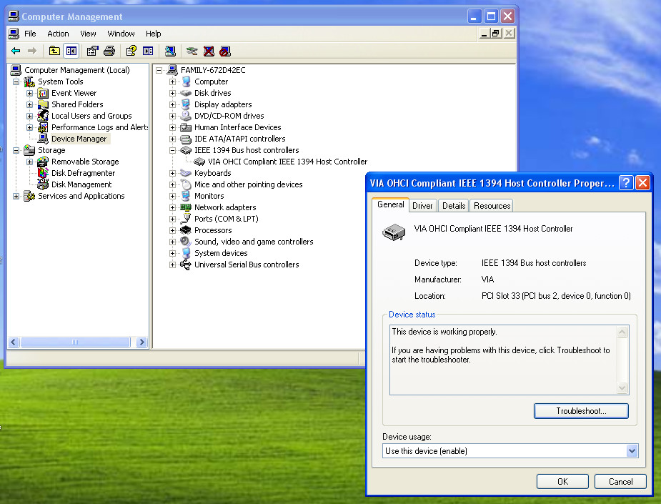

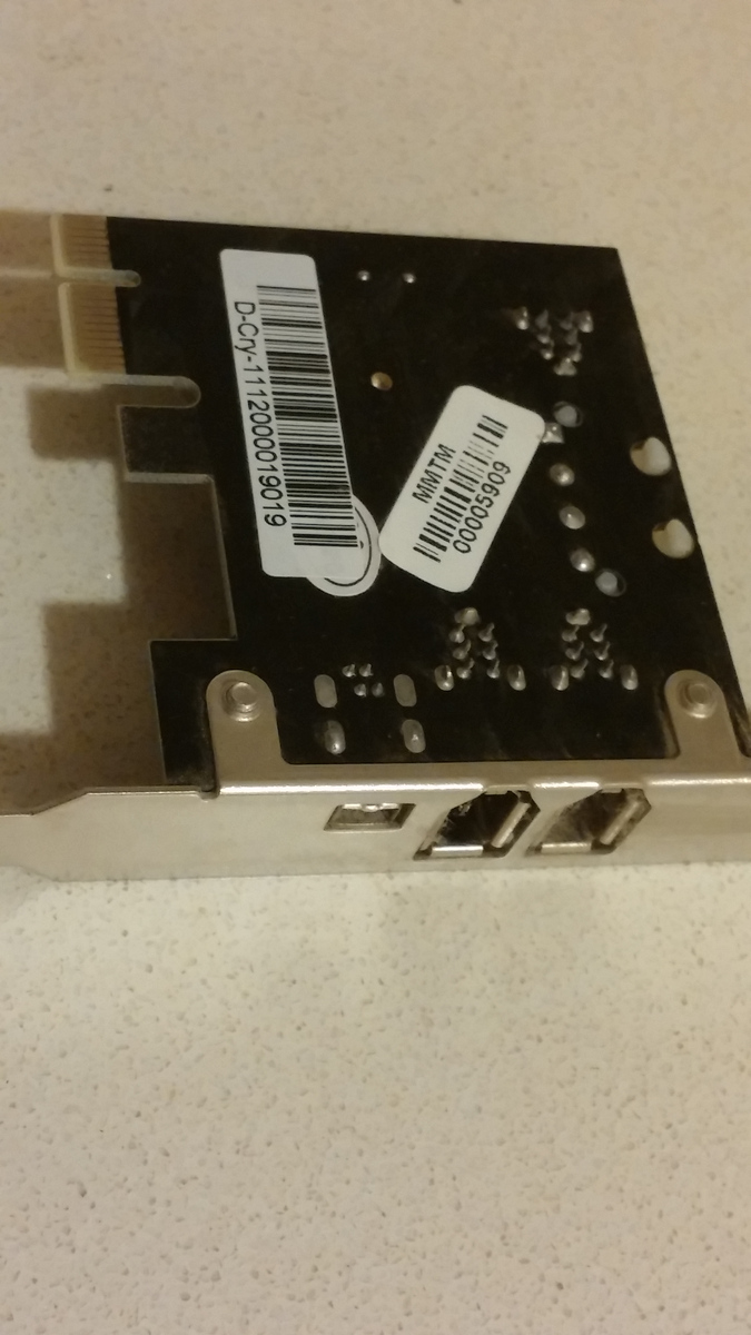

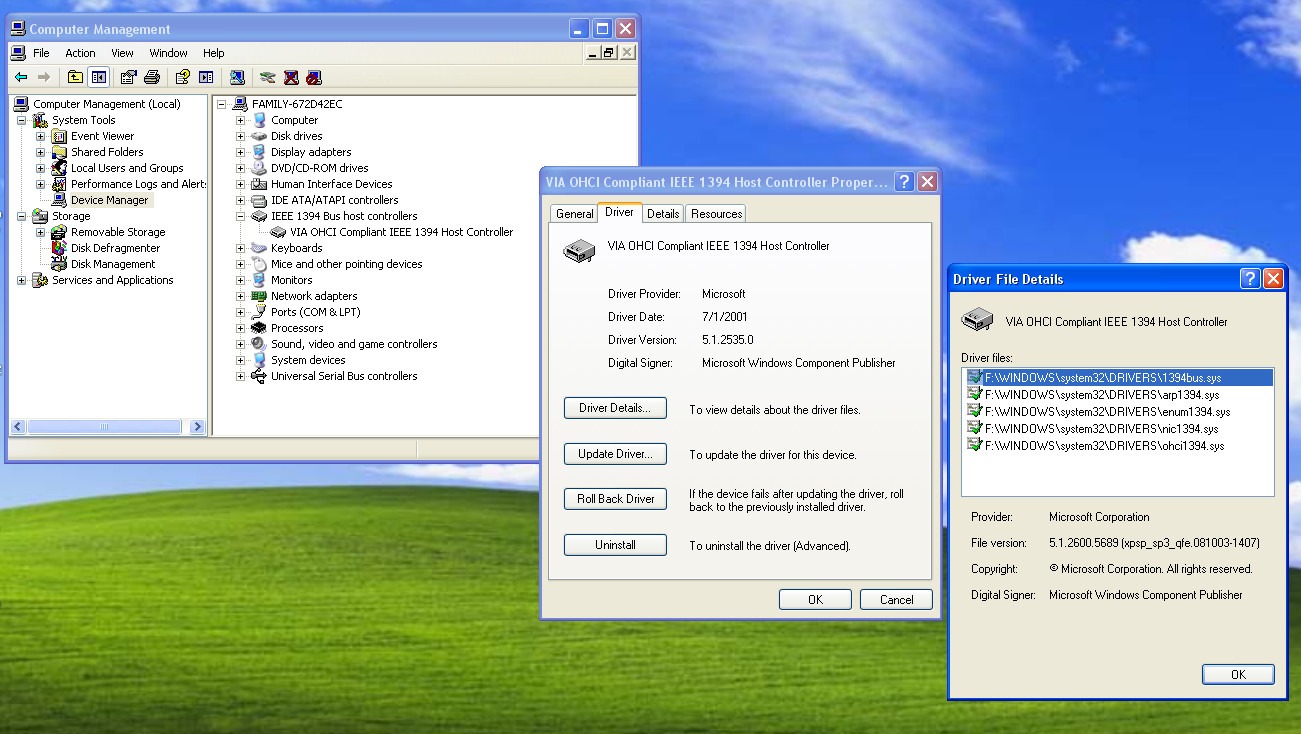

  9. Added 2 new images :
    1) my firewire card.
    It seems like the most generic card.
    I didn't see even a brand name.
    2) Firewire driver info.
    (remember that i'm using now Win.XP)

  10. Member DB83's Avatar
    Jul 2007
    That looks like standard Windows Drivers.
    So the card did not come with any other driver on a disk ?
  11. Banned
    Oct 2014
    Northern California
    Thanks.
    So the salesperson just gave you the card like that without a box or any drivers? Is this a new card?
    I hope he just did not sell you some crappy old card with free salesmen's promises.

    ...After a long...long... wait I've received the firewire manufacture name from the shop I bought....
    Is that a TI chipset-based FireWire card? Is it PCIe? Please post a picture of it showing the chip in detail so we can see it's indeed Texas Instruments, and another picture showing how you installed it inside the computer. I would do the following at this point:
