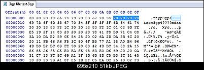

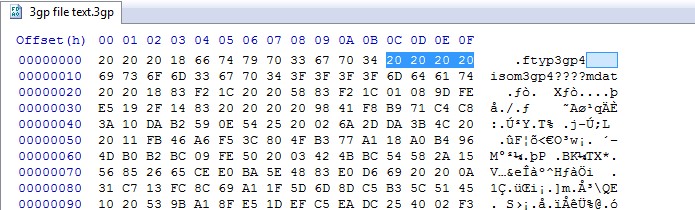

    It looks like it is trashed beyond repair. The one file has an MDAT and an FTYP but the bytes in between 'ATOMS' are supposed to be Null 'Hex 00'. That is because the 24 bits in front of an atom is the byte count of that atom. Notice all the Hex 20's in the first line, these should be 00's because ftype length should be hex 00 00 18 (24 bytes). The 3f3f3f3f in front of mdat means there should be over 1GB of MDAT and the whole file isn't that size.
    There is not a single 00 00 in the rest of the video so something has altered most of the file.. Just to be sure I ran it through the demo of Video Repair and is failed there also.
    Sorry...

  14. Originally Posted by Budman1 View Post
    Sorry...
    [Attachment 33904 - Click to enlarge]
    [Attachment 33905 - Click to enlarge]
    it should be a 17min audion file,the forensic fella copied my phone onto disk, i will get the disk and upload file from their, could it be that its a .3ga file?.
